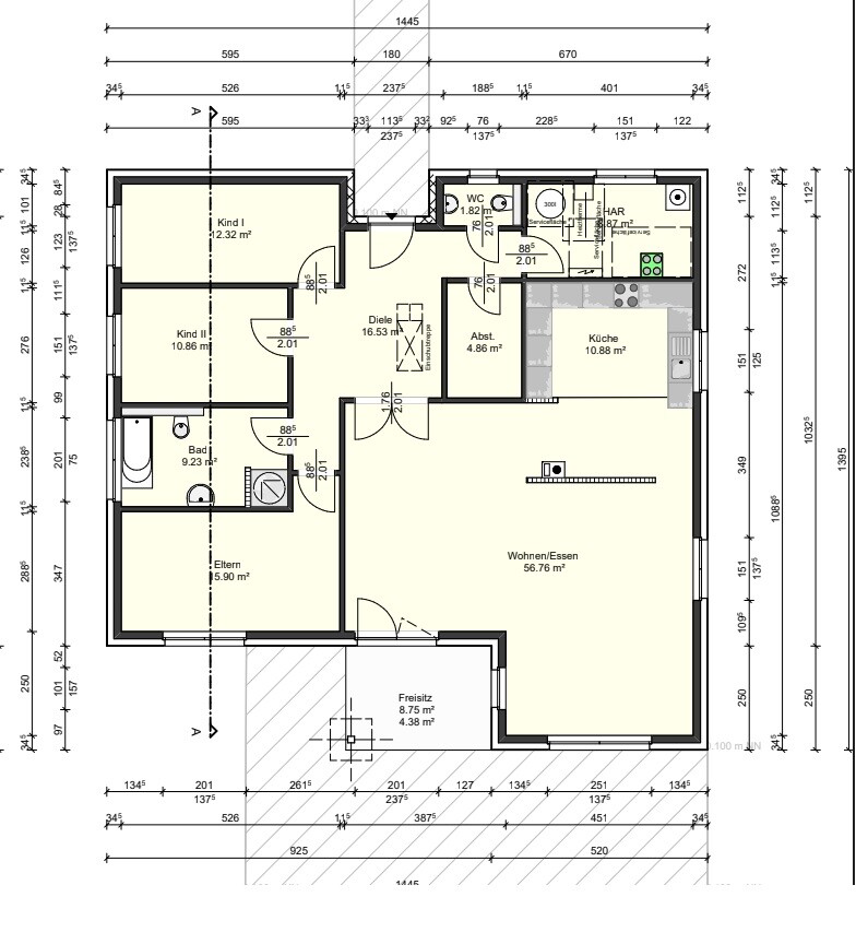

E
Evolith
13 Jan 2020 07:34
Otherwise, take a close look at our floor plan. It could be a great fit for you. If you basically close off the kitchen, you get an office, and you can slightly move the freestanding central wall to make the kitchen fit well there.
Grundriss eines Hauses: Wohnen/Essen, Küche, Bad, WC, Flur, Eltern- und Kinderzimmer, Freisitz.
