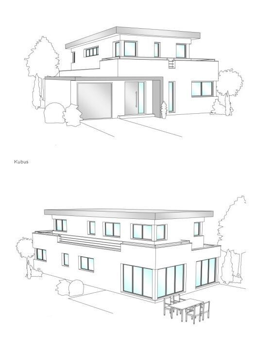

This is just my personal opinion and shouldn’t be given too much weight; it’s all secondary.
I wonder why something like this is marketed as innovative?
The problem with a homeowner who has been persuaded to build or accept these flat roofs is that water always collects in some gutter or recess. Why build something like this? Any traditional master builder would just shake their head – today, architectural designs receive awards that would have been called barns or farm sheds in the past.
Or why nail vertical fence slats onto the exterior wall of a house when the impregnation clearly deteriorates after 6 years? Why invest more than 150,000 euros in complex heating systems, including ventilation systems, etc., that become completely obsolete after 30 years? And so on.

kamnik schrieb:If you present your personal opinion as a topic for discussion, you shouldn’t try to pass it off as a fact. What you are sharing here is at best ill-considered—and therefore potentially dangerous nonsense for inexperienced building novices.
this is just my personal opinion and should not be overestimated; it’s all secondary.
kamnik schrieb:This is a design tailored to a specific living situation; you copied the views from the entrance page of my website in the single-family house section. These views are an example of a cube-style building.
? I wonder why something like this is sold as innovative?
kamnik schrieb:Many of your so-called "old" master builders have actually created this dangerous nonsense. Incidentally, just like their “estimates” of a single-family house heating energy demand. I know quite a few of them and have “owed” them a lot of additional and unnecessary work. Currently, one of your old “masters” has again arbitrarily decided to install a heating unit with a 3 kW higher capacity—better safe than sorry. Apart from being completely unnecessary—the heating load calculation confirms the specified heating unit—this would have cost my client about EUR 5,000–6,000 more. That says a lot about these “old masters.”
The problem with a builder who has allowed themselves to be convinced to build these flat roofs. Water always stands in some kind of depression. Why build something like this? Any old master builder would just shake their head—nowadays architects receive awards for designs that would once have been called barns or haylofts.
