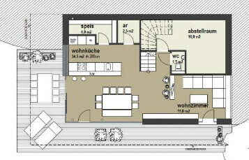

This is what a livable basement can look like:
Floor plan of an open living area with kitchen, pantry, storage room, toilet, and terrace

This is how a livable basement can look:
I would prefer if the lower side faces south/west. The storage room can also serve as a utility room.
If not, I would place the kids’ rooms and bedrooms downstairs.

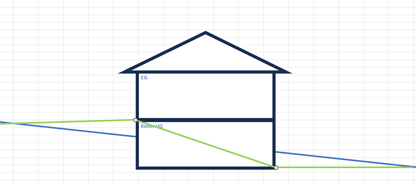

I roughly sketched it with a 10% slope of the original terrain (blue). The terrain modeling is shown in green.
Sketch of a two-story house with roof, basement, and colored lines (green/blue).
