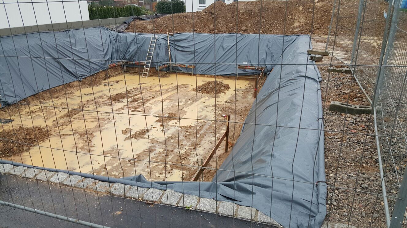

From rainwater or groundwater?
EveundGerd schrieb:
From rain or groundwater? I suspect rain... and after today, a bit more againSimilar topics
