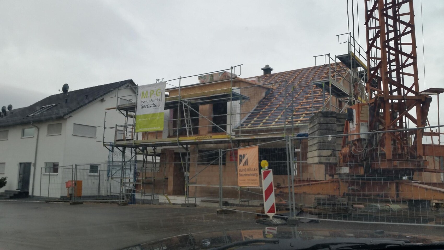

3 Mar 2016 06:32
We had to take about a one-week break due to the weather. Otherwise, the temperatures have always been borderline.
The roof is scheduled to be covered next week. Some mention a six-week shell construction phase; we did not manage that.
