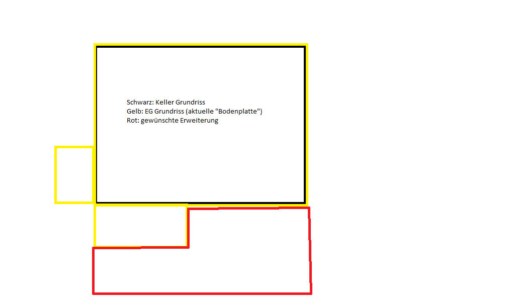

So far, we have only received the basement floor plan from the owner. We expect to get more plans over the weekend. Since everything is still pending, I don’t want to post the floor plan here. I quickly drew a simple sketch to show roughly what it looks like and what we would like to expand.
What information about the plot could be helpful?
The plot has a slope of 1° and the building area is large enough to increase the footprint.
The zoning plan requires an open building layout.
We want to first assess for ourselves whether such an extension would be generally possible, and of course, what costs might be involved.

hanghaus200021 Jun 2021 13:59Some measurements could still be helpful.
The plot has an area of 676 m² (7269 sq ft) with a floor area ratio of 0.4.
The basement is approximately 63 m² (8 m x 8 m / 26 ft x 26 ft), and the ground floor currently has about 73 m² (785 sq ft).
The building limit line is about 3 m (10 ft) down in my picture.
This means our extension would need to be approximately 8 m x 3 m (26 ft x 10 ft) minus about 4 m x 1.5 m (13 ft x 5 ft).
