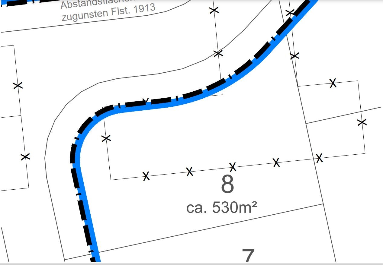

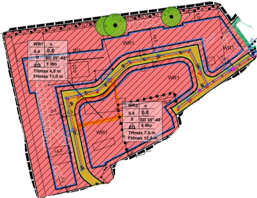

After a two-year search for a building plot, we were finally able to purchase our lot at the end of September in a quiet suburb of Bielefeld. Now we want to start planning. Our goal is to complete the project by the end of 2025. Since we are still unsure about how to proceed, we are seeking advice in this forum. I am attaching the development plan as well as the excerpt of the textual stipulations from the zoning plan. Unfortunately, the parcels are not yet registered in TIM or BORIS, so I cannot provide a larger spatial overview.

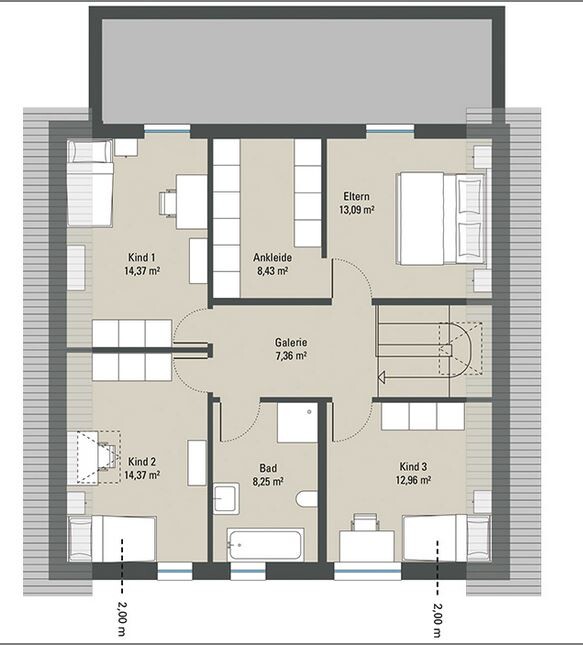

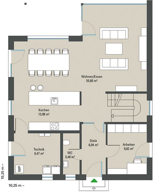

So far, we have reviewed various floor plans from large-scale builders of both solid construction and prefab houses. The design we like best so far is the "Eibenallee" by Gussek Haus. I am also attaching an image of the floor plan excerpt from the website and would be happy to discuss it here. However, since key dimension information is missing, it has limited usefulness.
- Very spacious living-dining area, bay window facing the garden, storage/technical room behind the kitchen, half-landing staircase, office on the ground floor, master bedroom with generous walk-in closet, two equally sized children’s rooms.
What do you dislike? Why?
- No direct access to the technical room from the entrance hall. We would like an adjacent laundry room off the family bathroom upstairs for washing machine and dryer.

Site plan of a building plot with boundary lines, paths and green areas

Floor plan of upper story with master bedroom, three children’s rooms, walk-in closet, bathroom and gallery.
Site plan of plot no. 8 (approx. 530 sqm) with winding blue path line.

I’m happy to share this with you, although the dimensions are missing here and there are probably countless planning mistakes included.
I’m amazed by how few errors your redesign* suggests, despite the fact that relocating the entrance has triggered a whole cascade of changes. The overall quality of the design appears to have been maintained, but the alterations are so extensive that the similarity to the original plan—for the construction process, even using the same building method—is now only visual. Structurally, hardly any beam (or stone) remains in its original position; technically, you have created a completely different model and could therefore just as well have started designing from scratch. The matching external dimensions only help with fitting the building on the plot, but beyond that offer no real advantage or value.
Bauneuling2024 schrieb:
I’m still not quite sure how to handle the estimated knee wall heights. Ultimately, this encouraged us even more to consult an architect.
Yes, see an architect (and I mean without quotation marks). The term “knee wall” caught my attention—I initially thought a two-story design might still be possible. Now I understand the "Eibenallee" design: it’s clearly aimed at zoning plans that allow only one full floor. That’s why the ground floor is enlarged with the bay window, and in some federal states you can order the knee wall to be higher than in others. Your shower would need a dormer here, and children's rooms wouldn’t extend beyond a knee wall height of 160cm (63 inches). Also, the wardrobe near the eaves in the dressing room would, with the original knee wall height of 110cm (43 inches), only have space for a chest of drawers.

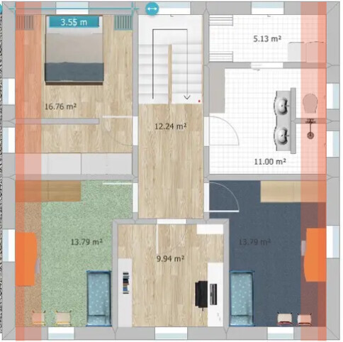

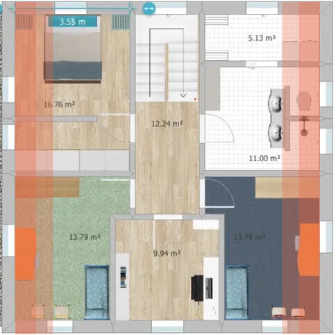

I have marked for you the zones where the roof pitch (38° in both cases) rises from a knee wall height of 110cm (43 inches) and 140cm (55 inches) to a headroom of 1.6m (5 ft 3 in) and 2.0m (6 ft 7 in):

Technically, you have created a completely different model and could have just as well started planning from scratch.
I realized that when creating the plan. Limiting the design of the building volume to the format of the model house floor plan gave me, as a layperson, a sense of planning security. So I didn’t have to think too far outside the box 😉.
The word “knee wall” caught my attention; at first glance, I would have thought a two-story design was possible. Now I understand the "Eibenallee" design: it’s clearly intended for development plans restricting construction to only one full story.
Exactly. We selected the model floor plan, specifically the "Eibenallee," based on its compatibility with the development plan and our space requirements.
A shower here would require a dormer, and the children’s rooms would no longer start at a knee wall height of 160cm (63 inches). Also, the wardrobe closer to the eaves in the dressing room would, with the original 110cm (43 inches) knee wall, be just a chest of drawers.
I had imagined the ridge running in an east-west direction. Thanks for your illustration in #8, though—it really helps to get a clear overall idea of the roof slope zones.

Ah, I see—my misunderstanding. Then my previous comments don’t really apply: the children’s room, dressing area, and bathroom are outside the risk zone, a dormer might be more suitable for the study rather than the bathroom, and the utility room ends up being the one affected, like the dog-bitten last area. The dimensions remain the same due to the square attic layout.
