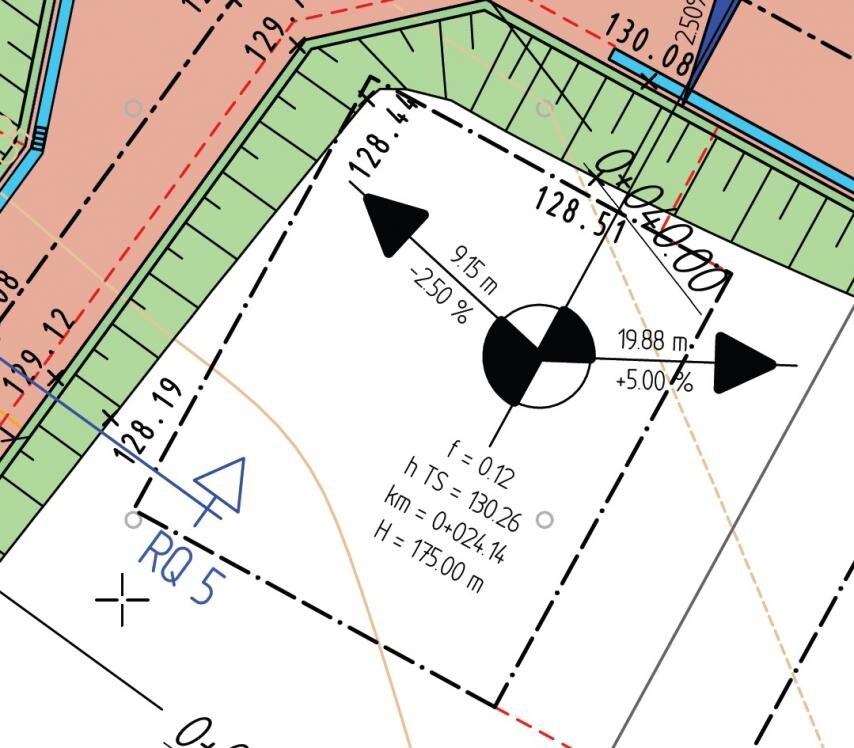

After initially planning the floor layout without a basement, we have now received the ceiling height plan from the building authority (see attachment).
It shows that our building plot (new development area) will be located 1.5m (5 feet) below street level. According to the development plan, raising the ground to street level is permitted.
We definitely plan to do that! Being below street level, especially as the last plot on a slope, doesn’t seem ideal during heavy rain...
Given these conditions, I almost have to build a basement, right? Otherwise, I would have to raise and compact the entire plot... That would be madness!
Excavating the basement should also be cheaper since it wouldn’t be so deep and there would be little or no soil to remove... Am I correct?
What do you think?

PeterLustig497 Nov 2013 10:48Irgendwoabaier schrieb:
in similar situations, some people here have planned either with a second apartment on the lower floor or with a garden entrance at that level. The most extreme example: the garage integrated into the house at street level, kitchen/living room also at street level, and the bedrooms plus a second living room on the floor below. The roof (gable roof, 20° pitch) is right above the kitchen/living room, while the garage has a flat roof… It has its charm as well…
Regards
I.A good idea…
For us, I think it would be difficult to implement.
According to the purchase agreement, we have to raise the plot to street level…
Since we have a corner lot, the street runs along the garden as well.
Additionally, our neighbor is building without a basement and is completely raising their ground level.
That means our garden would be in a depression based on your suggestion and could become a pond during the next heavy rainstorm… ;oP
But I will mention it to the architect, as I generally find the idea interesting…
