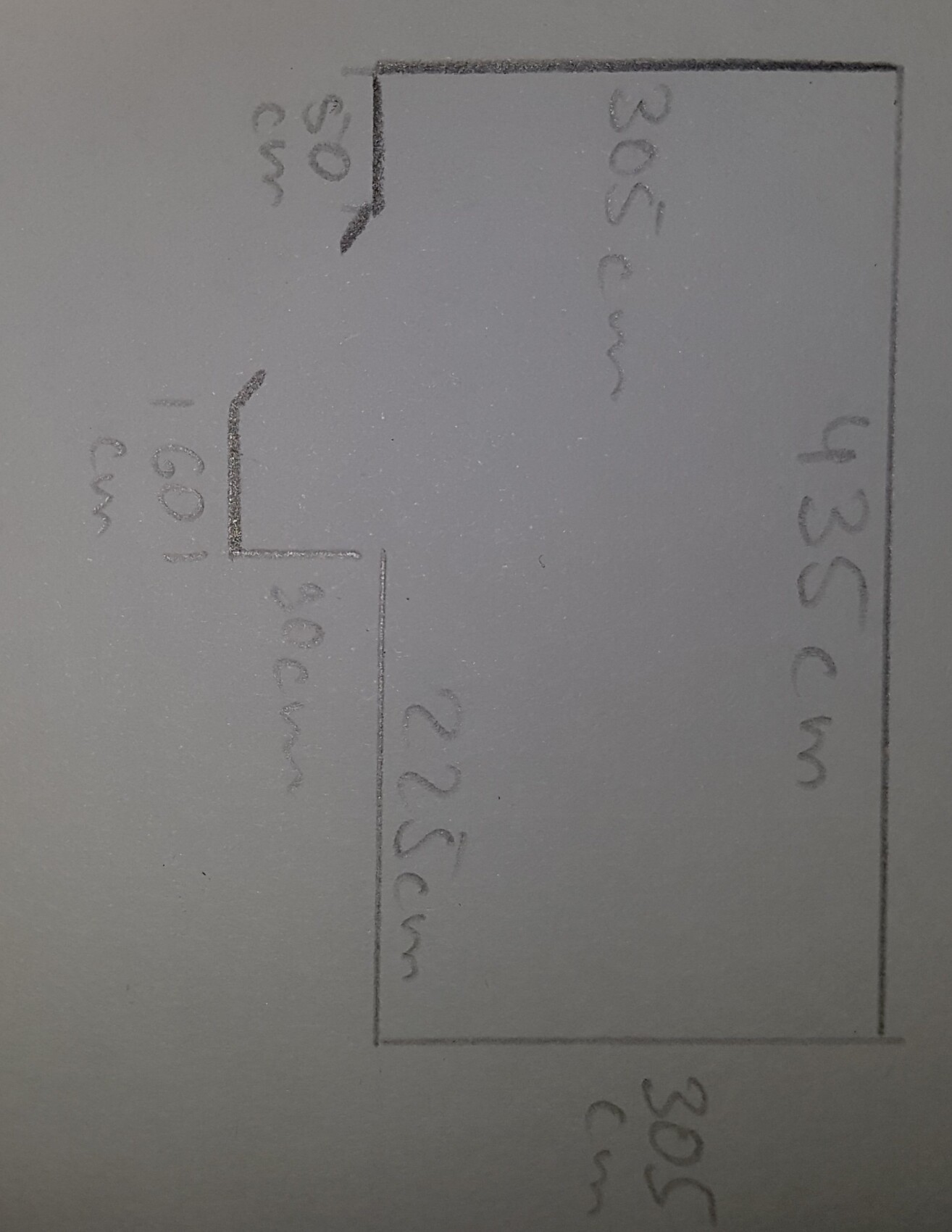

Bathroom, wanted to include a sauna, but passage between sink and bathtub is only 66cm (26 inches) wide (see attachment 3)

In the third attachment is the bathroom with sauna, but the passage is difficult. Do you have any ideas on how to design the bathroom so everything fits?

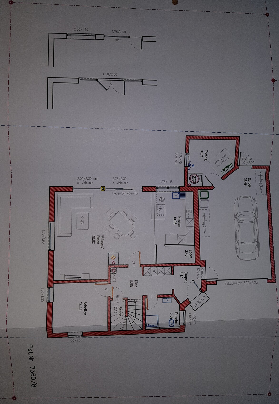

I would paint the roof terrace. Since the garage is built on the boundary line, it might be that even with a 3m (10 feet) distance from the terrace, the whole setup is not likely to get building permit / planning permission. At the same time, how often do you actually use a roof terrace if you have a nice garden terrace?
hanse987 schrieb:
I would reconsider the roof terrace. Since the garage is built on the boundary line, it might be that even a 3 m (10 feet) distance from the terrace is not approvable. It’s not a matter of might, it simply isn’t allowed. A roof terrace on a boundary line building is not permitted. Besides, a roof terrace is redundant if there is a garden.
What are the dimensions? I’m wondering if the living room wall is about 5 meters (16 feet), and the dining room 4 meters (13 feet). Then 3 x 4 meters (10 x 13 feet) in the dining area would just be enough for a rectangular table. The pantry access will look different than in the photo since a side-by-side fridge is shown there.
For the guest WC, it might be better to place the window on the east side so that people ringing the doorbell aren’t immediately surprised by any noises. Then, a shower could be installed in the niche (wall at 90 degrees). The partition wall between house and garage should be straightened out; it’s unclear why there’s a step there. The garage-to-house door takes up space and seems redundant because the main entrance door is right there. Which wall is the upper floor adapted to? Something must be off in that corner…
The front-facing windows don’t exactly invite you in either…
Anyway, consider why rectangular rooms are built or if you prefer to be surprised by what the bricklayer makes of these walls. There is a potential for mistakes. Usable floor space is reduced, and furniture is generally designed for 90-degree corners. Dirty corners will form everywhere.

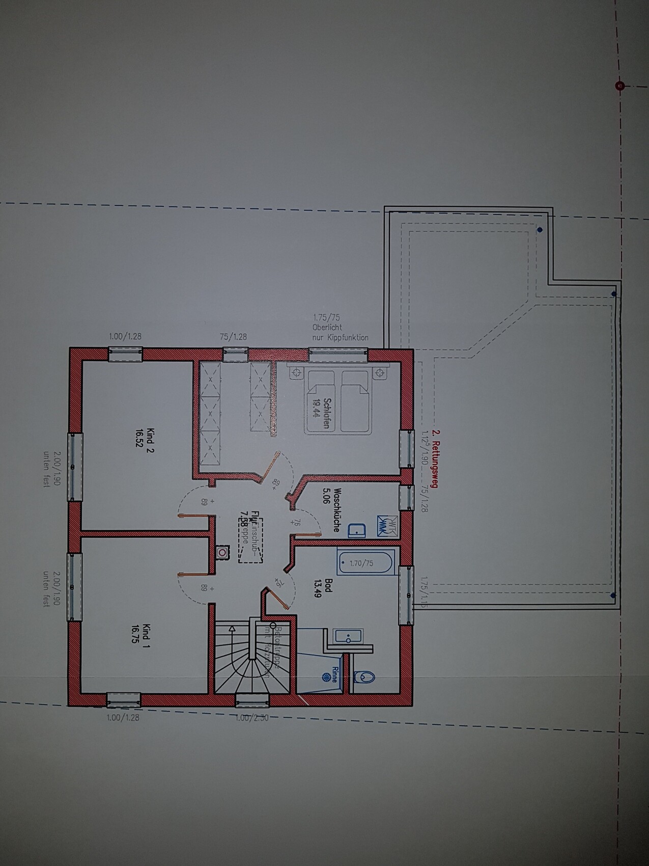

On the upper floor: if the chimney is moved into a child’s room, the corridor can be made narrower (ideally rectangular), and the rooms on the right side become more functional. The bedroom is accessed through the walk-in closet with a straight wall. The shower could be placed next to the bathtub behind the door, allowing space for a sauna. The garage seems to be over 4 meters (13 feet) wide, so a small corner exit could be planned from the bathroom onto the garage roof.

The house was based on a larger design my sister created together with the planner. It was simply reduced to 160m² (1,722 sq ft) of living space.This detail does not sound familiar to me – did you perhaps not mention it in the green forum?Reductions rarely turn out well and often lead to bottlenecks, folds, and similar issues. Changing the size but keeping the same layout usually causes problems – a small consolation is that the same applies, more or less, when enlarging.
Why finance through L-Bank?
Where is north?
Is there a plan with dimensions?
1st view, similar to Hampshire, not too bad
2nd view, someone seems to have a preference for slanted walls and a phobia of 90-degree corners
3rd view, dimensions are missing and no scaled furniture has been drawn in yet
Make sure to add these
Ground floor
Paint the door to the garage
Storage – what is going to be stored here? Please add furniture, freezer
Make the door wider because water crates, filled folding crates, etc. will be carried through
Draw in the stove
A proper dining table might be tight
Do you really need the home office at this size?
The utility room location is inconvenient and expensive
The walk-in closet is quite narrow; 75 cm (30 inches) between the wardrobes in rough construction measurements is very little.
Straighten the bathroom, bedroom, and utility room
The bathroom is quite small for a family bathroom and sauna. 66 cm (26 inches) is tight
I would integrate the building services (mechanical room) into the house and remove the slanted walls
Carport with a proper storage room
Possibly give up the cramped walk-in closet to make the bedroom larger
