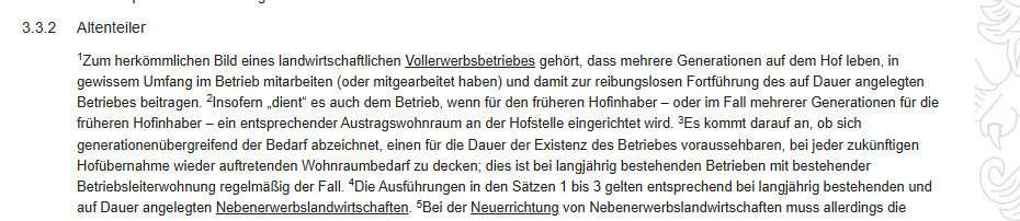

In our region (eastern Bavaria), it is almost standard for the children's new house to be built next to the parents' original farmstead. According to an employee of our local authority, the multi-family dwelling is often planned together with the manager’s apartment.I would apply that here as well, or designate the new building as a retirement house.Schorsch_baut schrieb:
There was a recent change in the building code that is supposed to make it easier for children to build on their parents’ property.Could you please emphasize that (without a link, as you know) with some more details?https://www.instagram.com/11antgmxde/
nordanney14 Nov 2024 16:24hanse987 schrieb:
In our area (Eastern Bavaria), building the children’s new house next to the parents’ old homestead is almost standard practice. Oh, I hadn’t mentioned it before. This is the usual retirement property arrangement.
Quote from the announcement by the Bavarian State Ministry from 2021 – so you have a relevant reference (even though it is regulated similarly throughout Germany).
Therefore, I want to reaffirm my personal assessment that, given the conditions, you should not have any problems with either renovation or new construction. Assuming you have a suitable architect.
