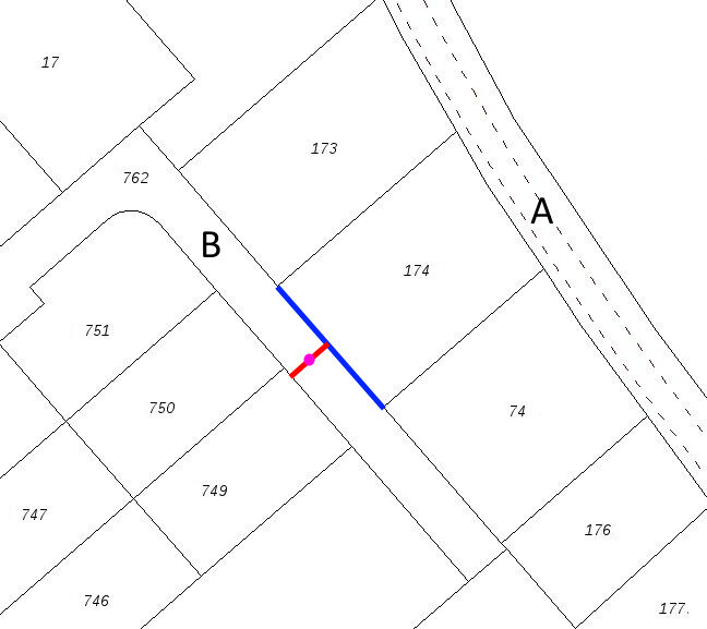

Marcello schrieb:
how exactly I determine "A" and "B" You don’t need to determine "A" and "B." Your property is either on planned street "A" or planned street "B." Unlike your case, my example plot borders two streets, so the development plan should clearly specify which street is applicable. Here, let’s assume it’s "B." Then, the midpoint of the street boundary (blue) is identified, and at that point, the midpoint of the street (red) is determined. The elevation of the magenta point is then the reference height. While the midpoint is clearly definable for plot 174, for plot 751 this is no longer possible, which is why I criticize the definiteness of the eaves reference point.

Marcello schrieb:
that the basement will definitely be fully below ground level If I have correctly identified your property, your garden is about 1.5m (5 feet) below the street reference point, so I see no obstacles to having the basement protrude enough toward the garden to allow for regular windows or even an exit. The architect will have to figure this out considering the full-story regulations and eaves height.
Escroda schrieb:
While the center point for plot 174 can be clearly determined, this is no longer possible for plot 751, hence my criticism regarding the definiteness of the eaves reference point.Thank you. Now I understand. Due to the curve, it’s indeed not that easy with my property. But even with a rough estimate on my part, the variation shouldn’t be that much. I think, as you already wrote below, that we are about 1 to 1.5 m (3 to 5 feet) below the reference point at the center of the property.
