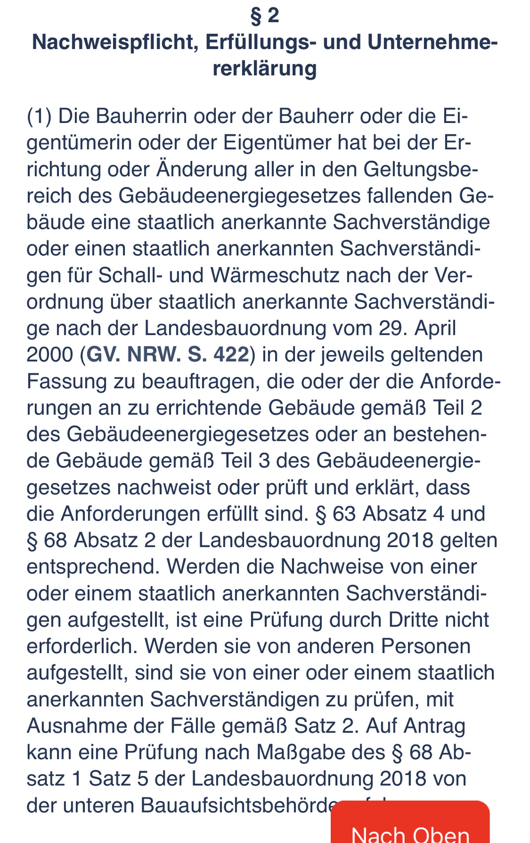

According to federal law, every builder must prove that the requirements of the Building Energy Act are met.
When and how this is regulated varies by state; you can find details for North Rhine-Westphalia (NRW) in the “Regulation on the Implementation of the Building Energy Act.”
Schnittbild eines Gesetzestextes mit §2 Nachweispflicht, Erfüllungs- und Unternehmerklärung
When and how this is regulated depends on the states; you can find this for NRW in the "Regulation for the Implementation of the Building Energy Act."
This is the state regulation for NRW, but the TS is from Bavaria, so this does not apply.
According to the Bavarian AVEn (§2), the local building authorities (building departments) are responsible for enforcing the Building Energy Act.
In §5 paragraph (1) it states that before construction begins, a declaration of compliance (whatever that may be) proving adherence to the Building Energy Act requirements must be submitted. This is probably something like a thermal insulation certificate?

Oh, sorry, regarding North Rhine-Westphalia. I have no idea how I got that wrong.
But no matter the federal state, you probably can’t get around it because of federal law. I looked it up a while ago since our energy consultant was reluctant and not very forthcoming with information.
