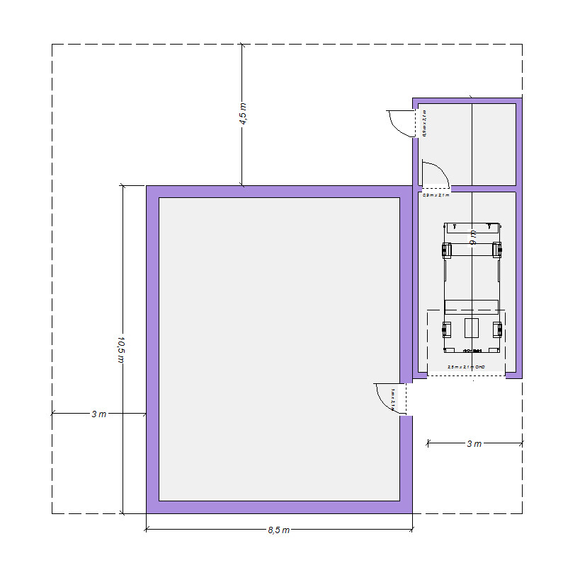

No, it doesn’t. What is binding for you initially is the development plan, where it states II+S inside a circle. So, you have to build 2 full stories plus the attic. How the attic is defined can be found in the building regulations of your federal state, which we still don’t know. It is in Bavaria, I actually mentioned that above.
Scout schrieb:
We also have a traffic-calmed dead-end street at the end of a row of terraced houses, where usually only two neighbors drive behind. The “front yard” is about one meter deep (around 3 feet), like with all neighbors, and without any fencing. This basically serves as our walkway, which causes no problems since there is no through traffic and mutual consideration is not unknown. That’s good to know. We will certainly also get in touch with the future neighbors to the south of our site to find out about their plans.

Davidoff86 schrieb:
But the front door practically right on the street, even if it’s barely trafficked?? I don’t know...No, my first thought would be something like this:Although I don’t know the details from the development plan regarding the boundary buildings with outbuildings.
