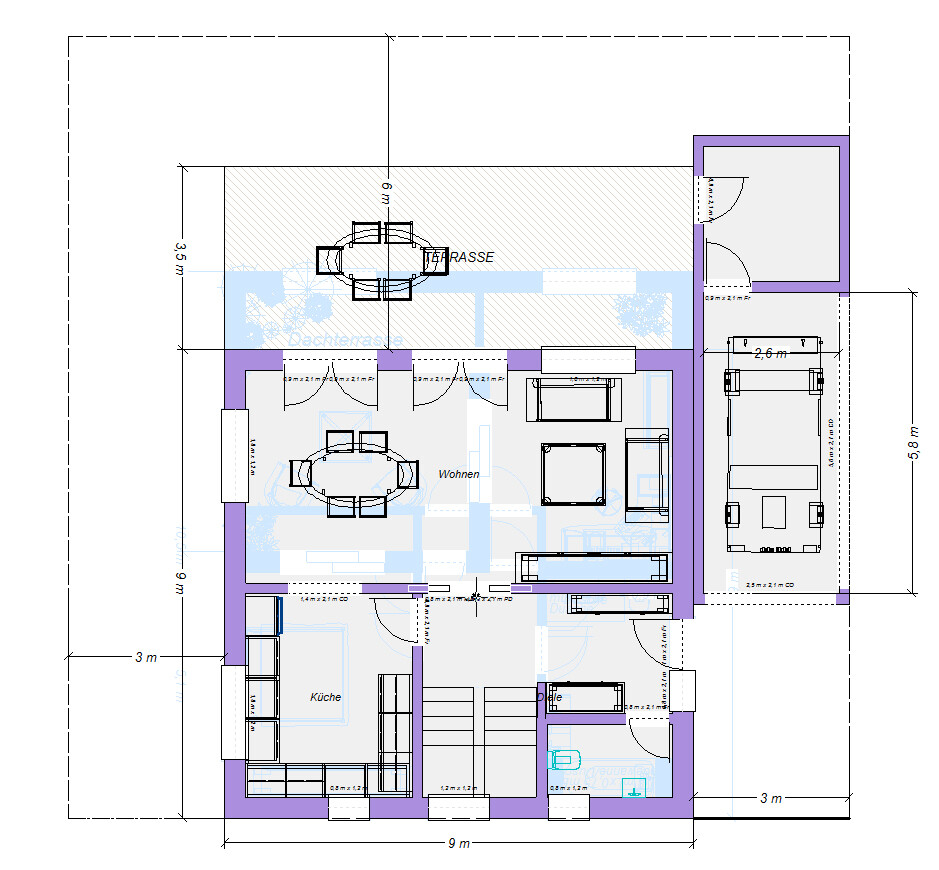

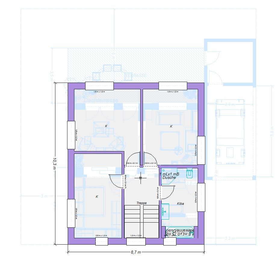

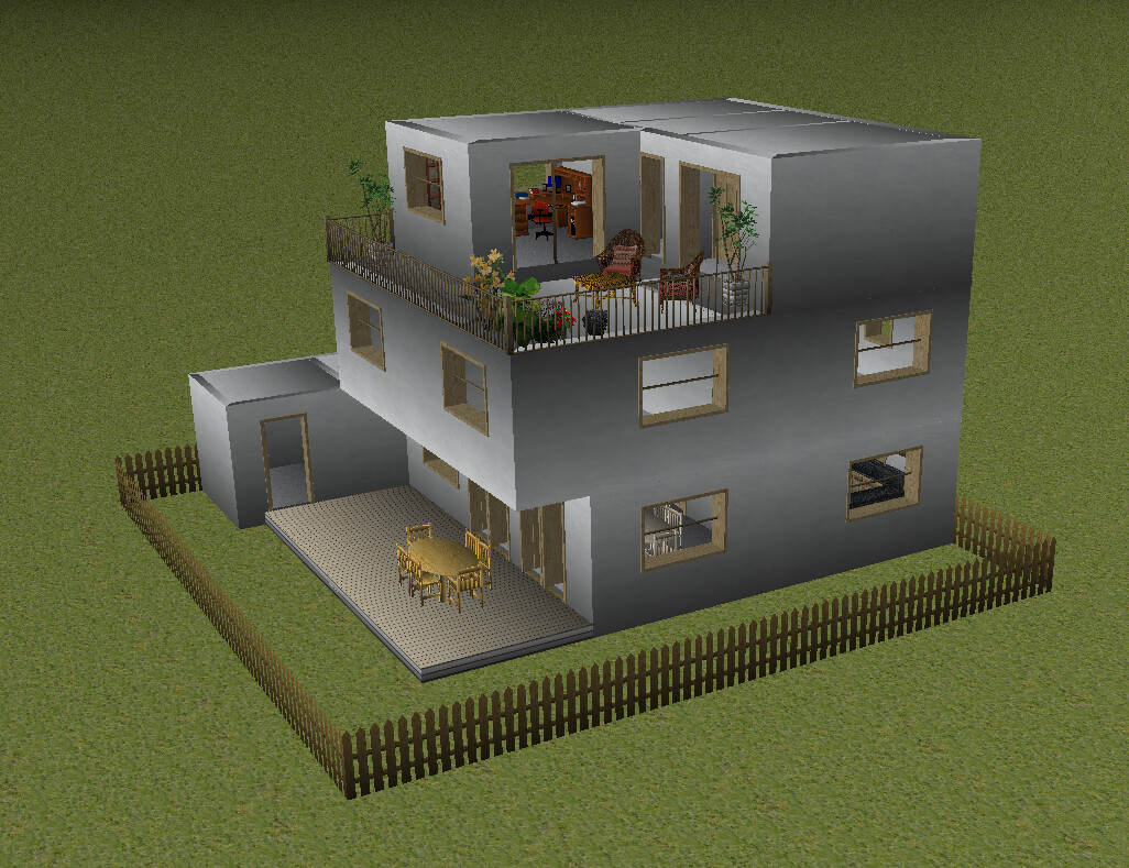

If there were enough budget, it would be possible to build here with a basement and an overhang. This way, there would be a semi-covered terrace with an adjoining green strip wide enough for at least three blades of grass, comfortable children's room sizes, and a top floor with three bedrooms.
Something like this:
Two-story house with rooftop terrace, balcony furniture, terrace setup, and garden.
Two-story gray house with carport, red car, and wooden fences in the garden.
Floor plan of a house with kitchen, living room, dining area, garage, and terrace.
Floor plan of a house: central staircase, several rooms, shower, and rooftop terrace in the outdoor area.
Floor plan of a house with rooftop terrace, living room, office, bedroom, and shower
Please consider the old-fashioned fences, cars, and furniture only as a reference. The kitchen could possibly be planned more openly with an island, if desired.
I actually don’t mind the building line along the street anymore, as long as everyone follows it. A quiet residential street where the children's rooms face the front and the parents call the kids in from the kitchen for dinner—that has something cozy about it, and I can easily imagine it if you get along well with the neighbors.

It looks very stylish! There are some cool ideas included, but I suspect that a transition cannot be realized according to the building regulations / planning permission. The same applies to the rooftop terrace, although I’m not entirely sure about that and will definitely inquire further. What software did you use? CAD?

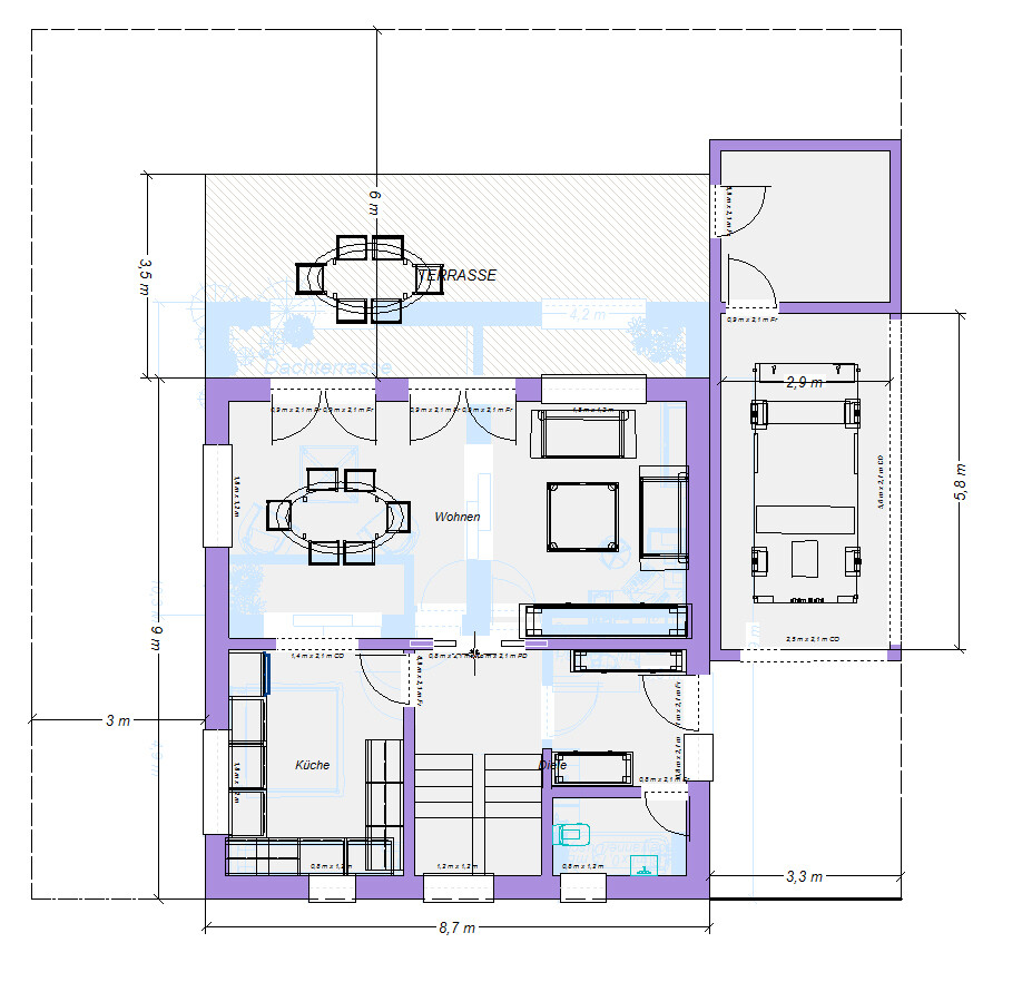

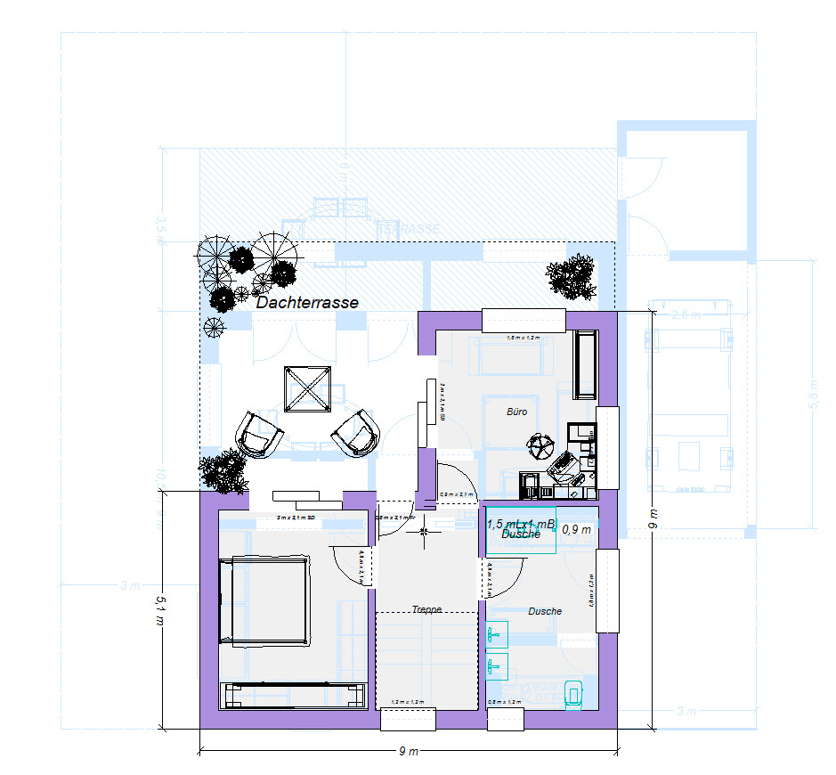

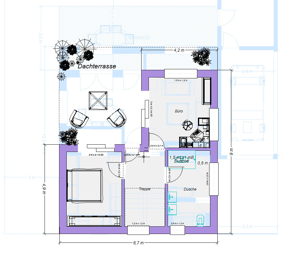

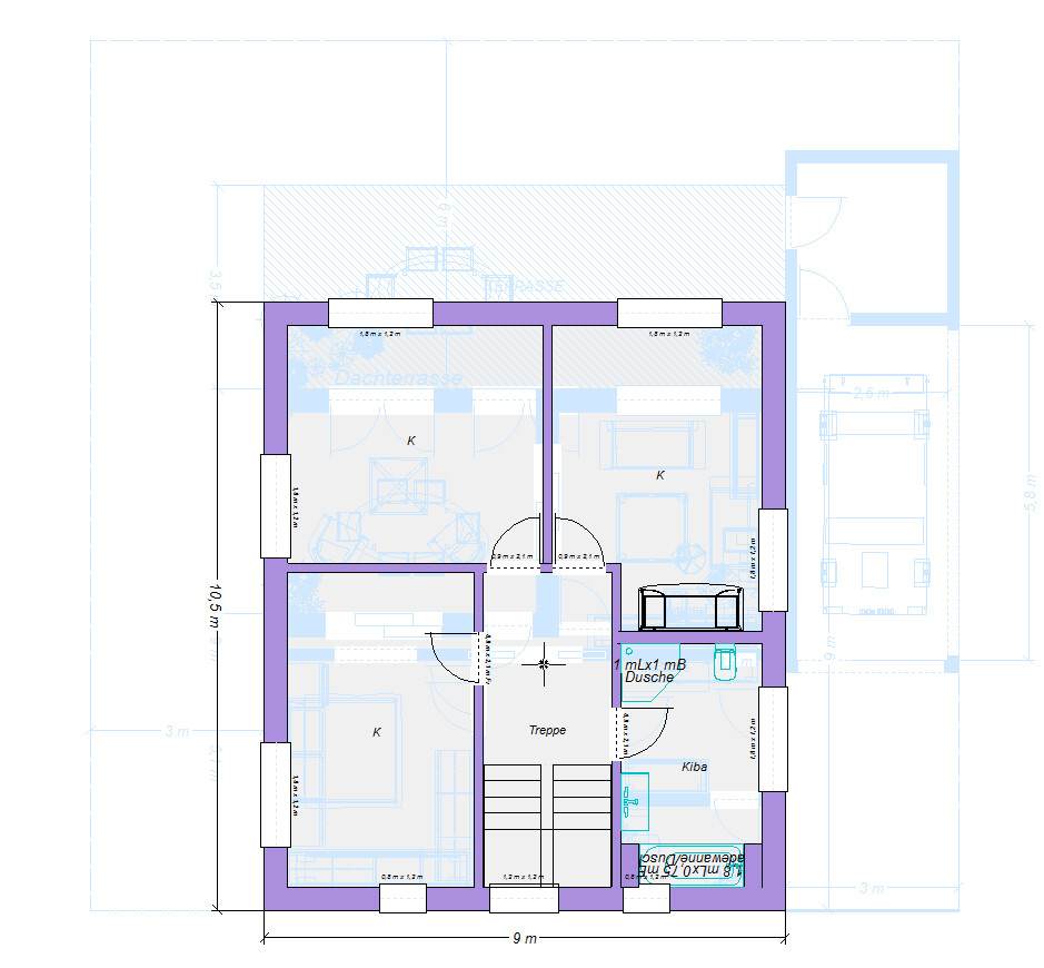

Oops, my mistake. I actually exceeded the floor space ratio. Yeah, I need to reduce a few centimeters (inches). Something more like this:
Floor plan of a house with kitchen, living room, dining area, terrace, staircase, and garage.
Floor plan of a house with central staircase, multiple rooms, and bathroom with shower.
Floor plan of a house with roof terrace, office, shower, staircase, bedroom, and garden plants.
Or is there any other reason against it?
I’m using Architekt 3D from Anno dazumal – you can tell by the old-fashioned stuff. But it’s good enough for sketches.
