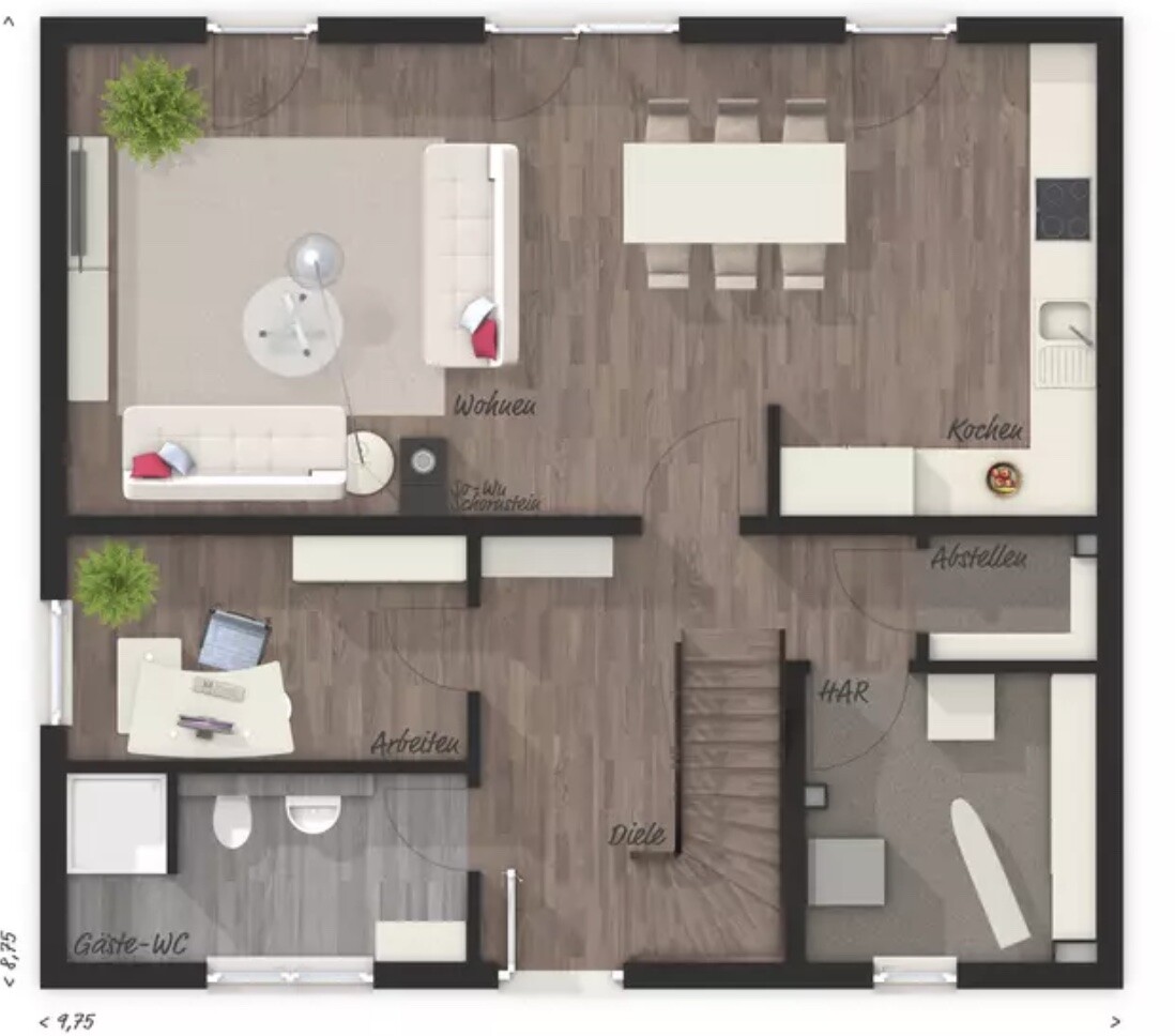

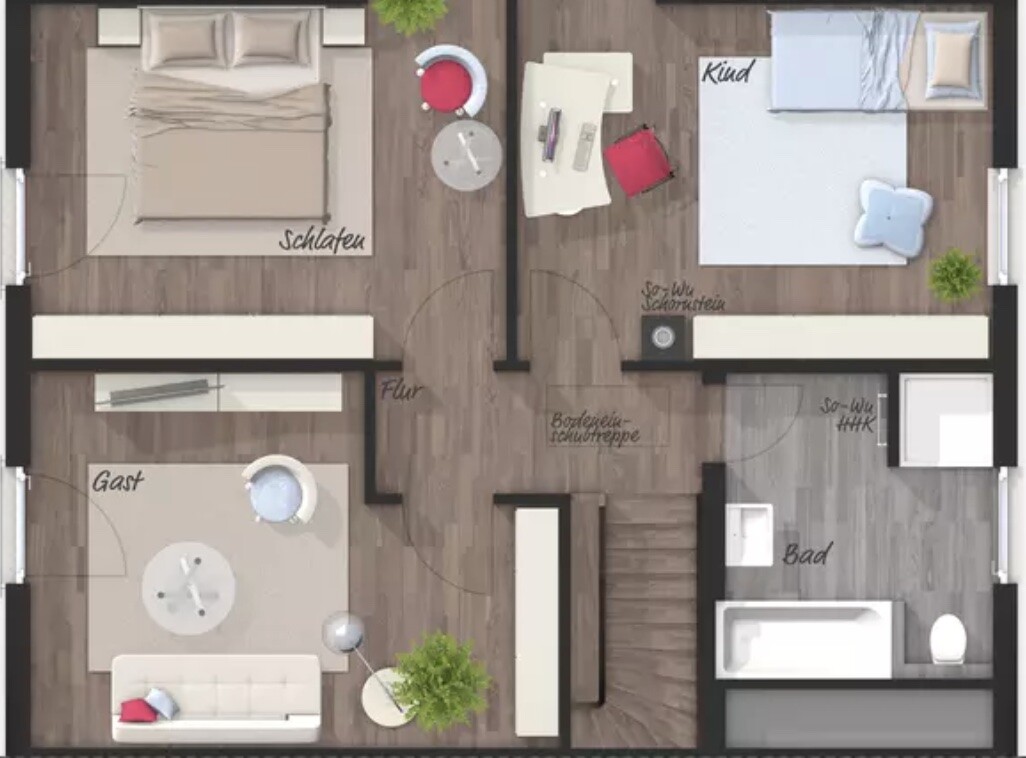

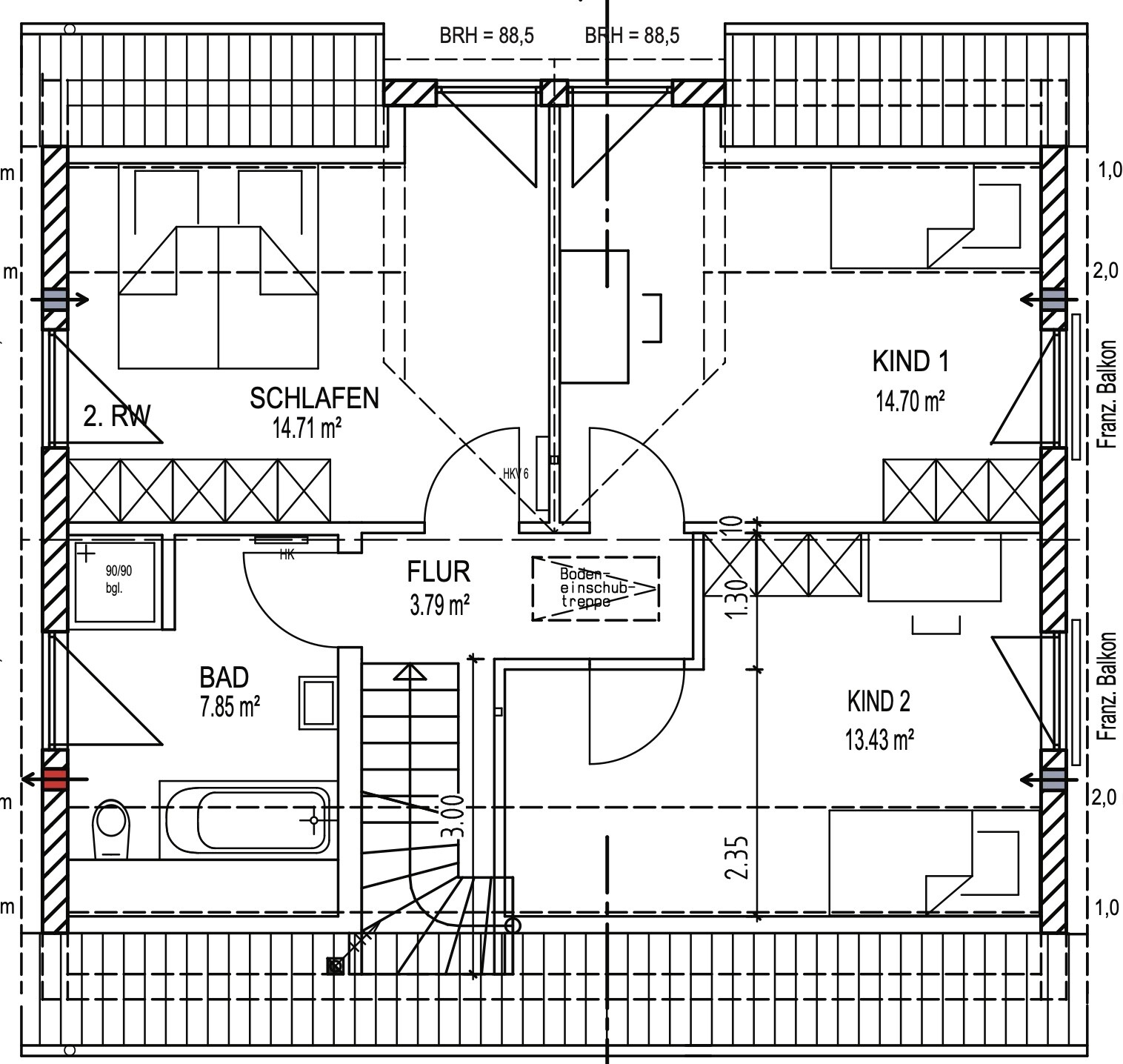

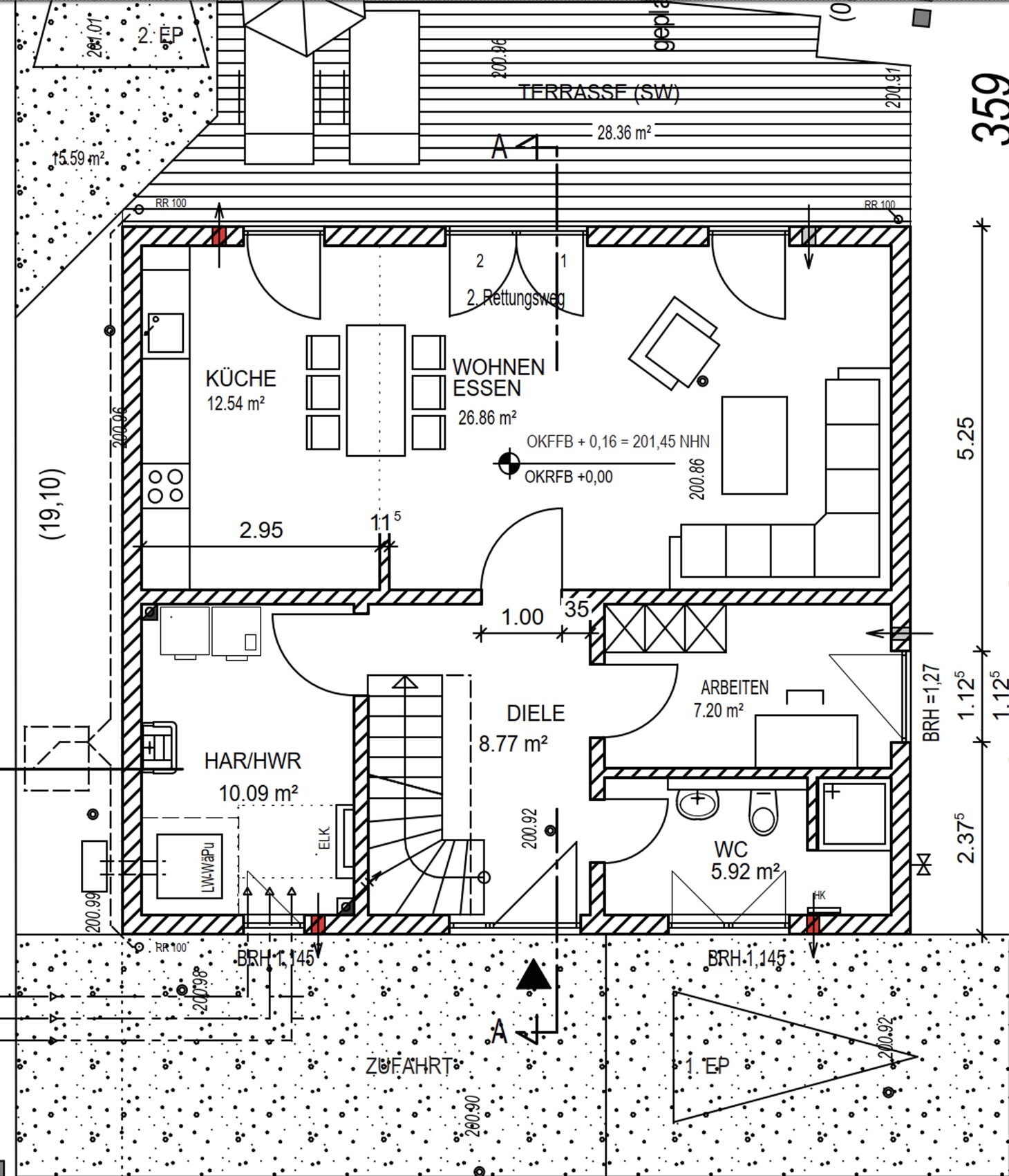

Vrumfondel30 Mar 2022 15:07Hoping not to infringe any copyrights, I’m sharing the before-and-after comparison as discussed. I no longer have the original plan, so I’m using the catalog image from Town & Country instead. As you can see, the room layout in our case is mirrored. And before anyone notices, the light switches are not exactly above step 5 as I initially wrote; they are actually a bit closer to the bottom of the stairs ;-)
Looking again at the attic floor compared to before, I’m still glad we rotated/moved the fold-down attic ladder—I can’t think of any reason why the original position would have been better. But surely there must be a reason, right? I’d be really curious, so if any of you have thoughts on that, please share!
