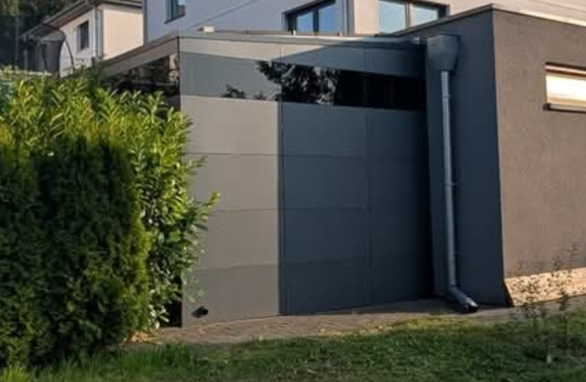

I built something similar using a timber frame. However, I think a 5° (9°F) roof pitch with an EPDM roof and roof tiles is quite low.
It is about 5 meters (16 feet) long and about 3 meters (10 feet) deep.
I anchored an 8x11 beam directly to the garage and placed the cross beams on it. I used post brackets at the corners.
I also have some pictures of the timber frame somewhere.
I clad it with HPL panels.
Where the shadow is, there is a door leading outside with folding hinges. You only notice it if you know it’s there.

tomtom79 schrieb:
I built something similar using a timber frame. But I think a 5° roof pitch with EPDM roofing and roof tiles is quite low.
Approximately 5 meters (16 feet) long and about 3 meters (10 feet) deep.
I anchored an 8x11 beam directly to the garage, and placed the crossbeams on top of it. At the corners, I used post anchors.
Somewhere I also have pictures of the timber frame.
Where the shadow is, there is an outward-opening door with folding hinges. You only notice it if you know it’s there.
It looks really neat. Why do you think the roof pitch is too low?
I’ll have to take a closer look at those hinges.
Back to the sliding door: the automotive industry manages to install sliding doors flush as well 😉 No offense, I’m just gathering ideas and this toy-like mechanism is quite simple 🙂
hanghaus20237 Nov 2025 09:46home2020 schrieb:
Why do you think the roof pitch is too low?Because you are planning to use roof tiles. They won’t work in this case.A
ajokr20257 Nov 2025 11:45I have roof tiles installed on a 20° pitch. Maybe you can get used to that.
