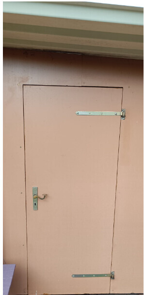

I would like to install the door flush with the wall. The door should open outward. Therefore, I am considering which hinges to use. Can anyone give me some advice? The Playmobil ambulance 71202 has a cleverly designed side door that opens smoothly. Is there anything similar available for regular doors?
hanghaus20236 Nov 2025 14:13home2020 schrieb:
So I’m considering which hinges to use.Sliding doors don’t require hinges.I wouldn’t recommend that either.
I have a flush door with hinges on my shed. The roof is trapezoidal metal sheets installed according to structural calculations, without rafters. The roof overhang is 0.5 m (20 inches) at the gable and eaves.
