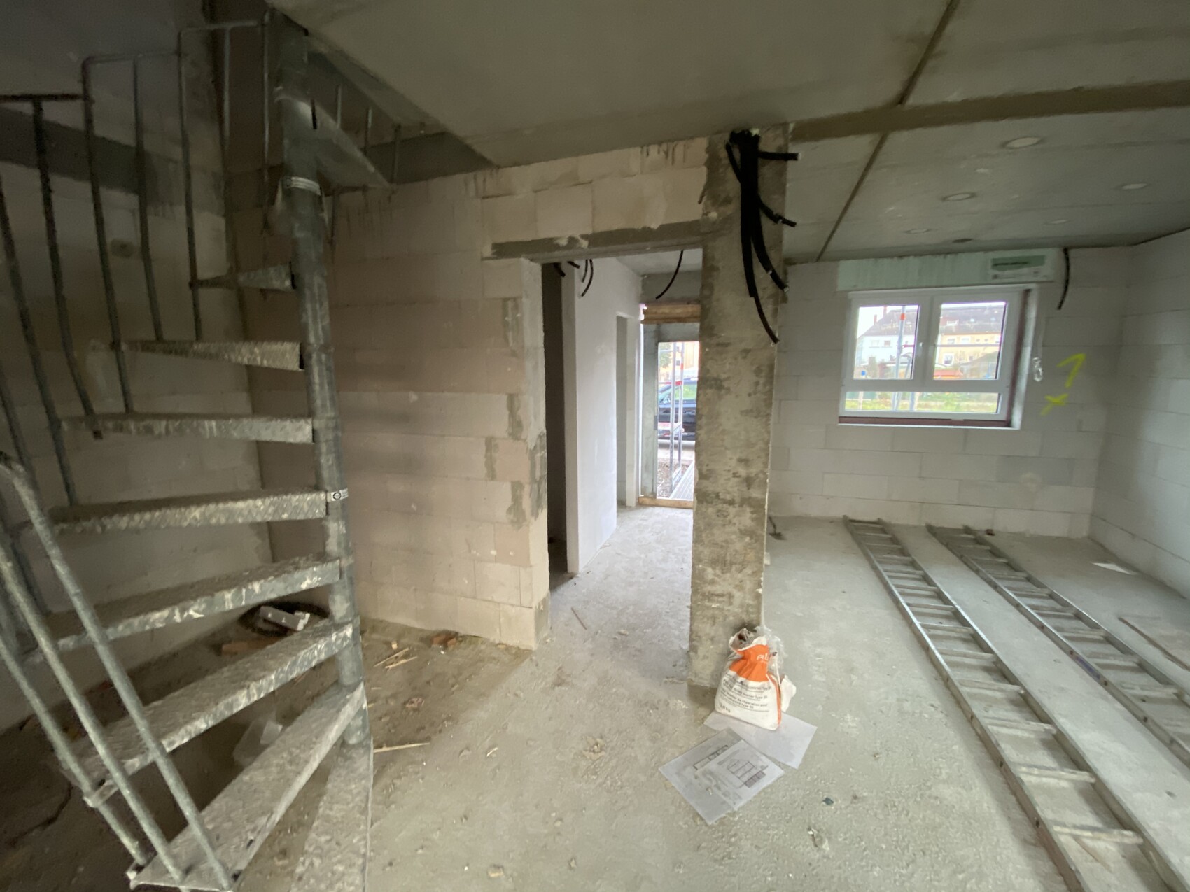

goalkeeper16 Jan 2020 06:43However, you should note that the price includes all materials and labor. Creating the hole, chiseling the slot, and laying the cable also costs money.
goalkeeper16 Jan 2020 07:19hanse987 schrieb:
Please make sure that the LAN cable is installed in the conduit according to DIN 18015.I believe he will definitely comply with the DIN standard – several empty conduits were already installed during the shell construction phase, as appropriate.
Wiesel29 schrieb:
I asked him how much a socket outlet with everything included (basic standard) costs. For the electrician, it’s about €5 net.Of course, the socket itself—that’s usually kept in the tradesperson’s office.But how does it get installed into the unfinished wall, and how is it powered: who cuts the chases, who installs the distribution boxes, who pays for the wiring, and who covers any necessary additional circuit protection? Who performs the final testing?
goalkeeper schrieb:
I believe they will definitely follow the DIN standard – several empty conduits were already installed during the shell construction phase, as they should be.You have to install everything inside protective conduits through the concrete ceiling anyway, including electrical cables. However, the electrical cables there do not necessarily have to be replaceable.
Data cables, on the other hand, must always be installed in empty conduits so they can be replaced later. This means you need to be able to pull them through, which includes maintaining the allowed bending radius (no 90° sharp bends!) and adding a pull box if there are a certain number of bends. Otherwise, even if the data cables are inside an empty conduit, you effectively won’t be able to replace them later!
From this perspective, make sure to check your data lines (LAN and satellite, possibly telephone) and insist on sufficient bending radii. After drywall installation, it will be too late.
Of course, the labor time is additional. My father and I really do everything ourselves. Actually, more my father since he has the necessary expertise. A week before last, we wired and connected a room with 8 outlets and 2 light switches in about 2 hours. If someone had asked me for $500 for that with material costs of $50–70, I would have laughed and run into a circular saw.
