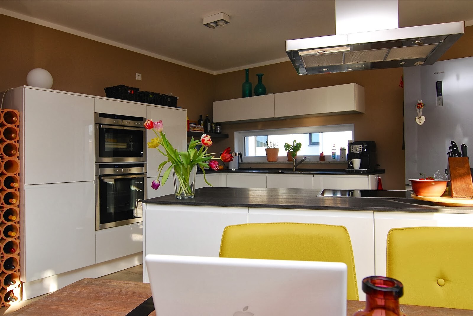

We have a stylish (though that’s always relative, no ribbed plastic or wood-look) modern kitchen of average size with a cooking island (90 x 180cm (35 x 71 inches)), mainly drawers (all 60cm (24 inches) wide) and Neff appliances (including a steam oven) for around 11,000. However, it’s not a granite or wooden countertop. So it’s manageable 🙂

So, an island kitchen for under €10,000 will be very difficult to achieve. It might be better to budget a bit more. We are close to €15,000, have chosen a high-quality oven, cooktop, and extractor hood. Otherwise, nothing extraordinary, just a branded kitchen from Alno tailored to our needs.
