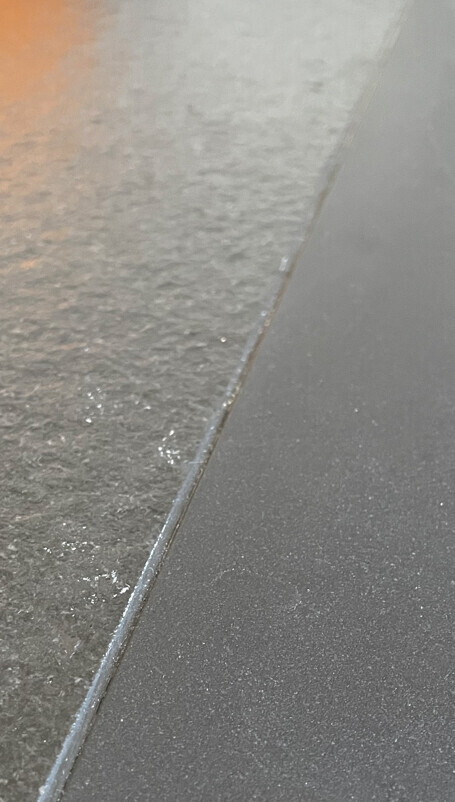

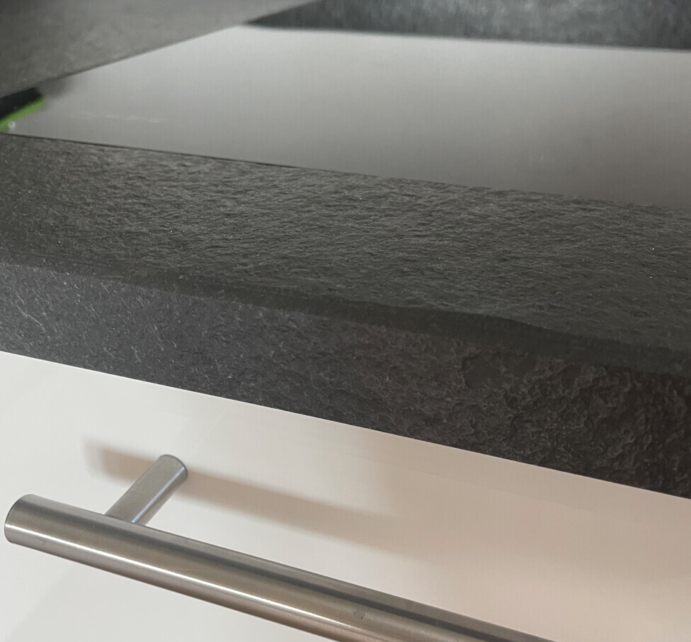

Axolotl-neu17 Jul 2022 14:22Bauenaberwie schrieb:
Recessed means that the countertop is supported underneath by wood. Not wood. The same material as the countertop itself. So granite. It looks like about 4cm (1.5 inches) solid at the edge.
Pacmansh schrieb:
Are you sure you want it recessed (I think you mean flush)? For the sink, I would definitely recommend an undermount. With the cooktop it looks stylish, of course. But with quartz you can have problems if pans hang over the edge (heat), and later it might be difficult to find a matching cooktop if the current one breaks. That’s why we chose an undermount sink and a drop-in cooktop. Pacmansh schrieb:
A flush sink really has to be done very well. Everyday business. The sink is no problem. It’s fitted with millimeter precision, just like the cooktop. If I’m spending a small fortune on such a countertop, I want it to look perfect.
