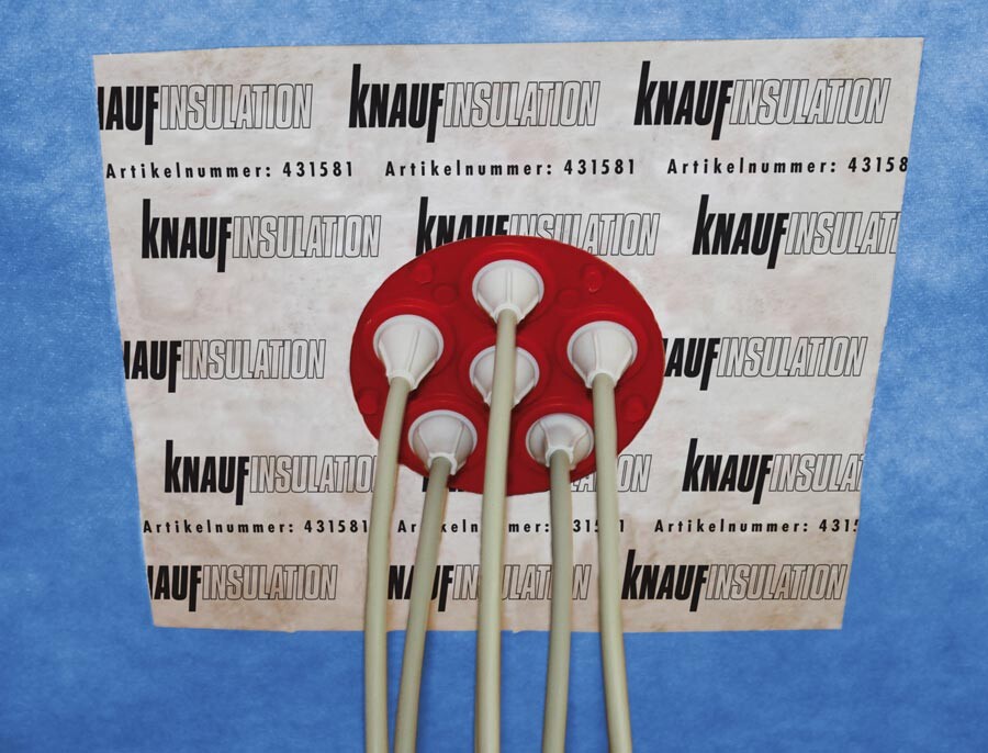

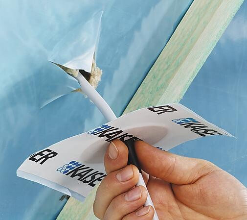

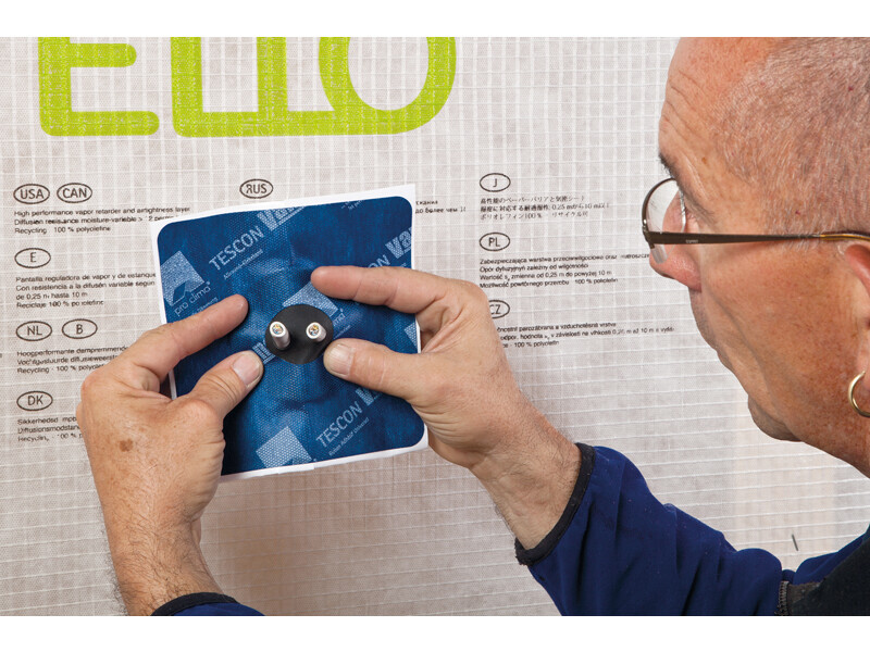

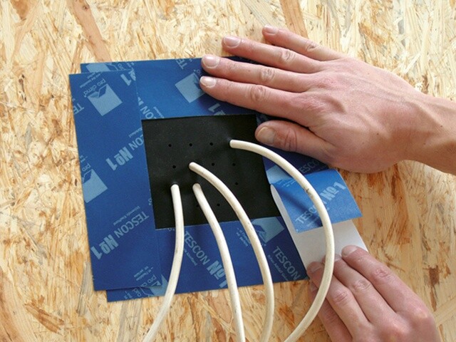

The collars can be used on a wide range of membranes/underlay sheets. You just need to order/apply the appropriate one for each product.
In the very first picture, you can also see that it can even be applied to OSB (oriented strand board) with the right tape.
Holes in membranes are always somewhat problematic because they compromise or completely undermine the function/purpose of the membrane.
