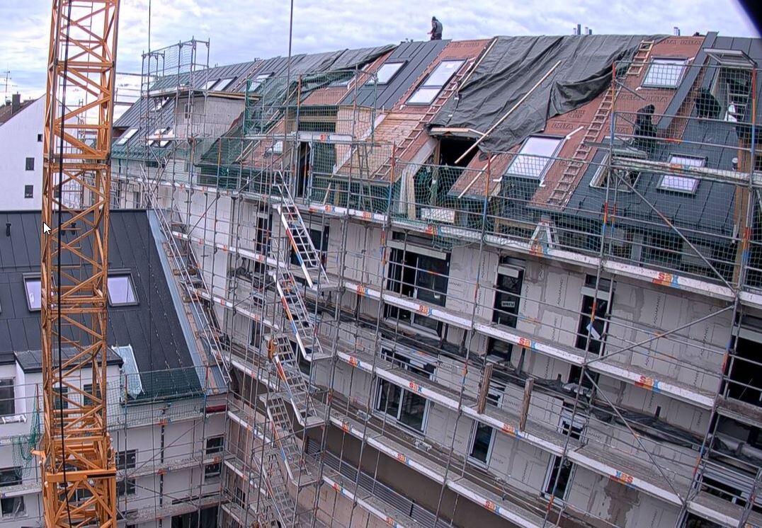

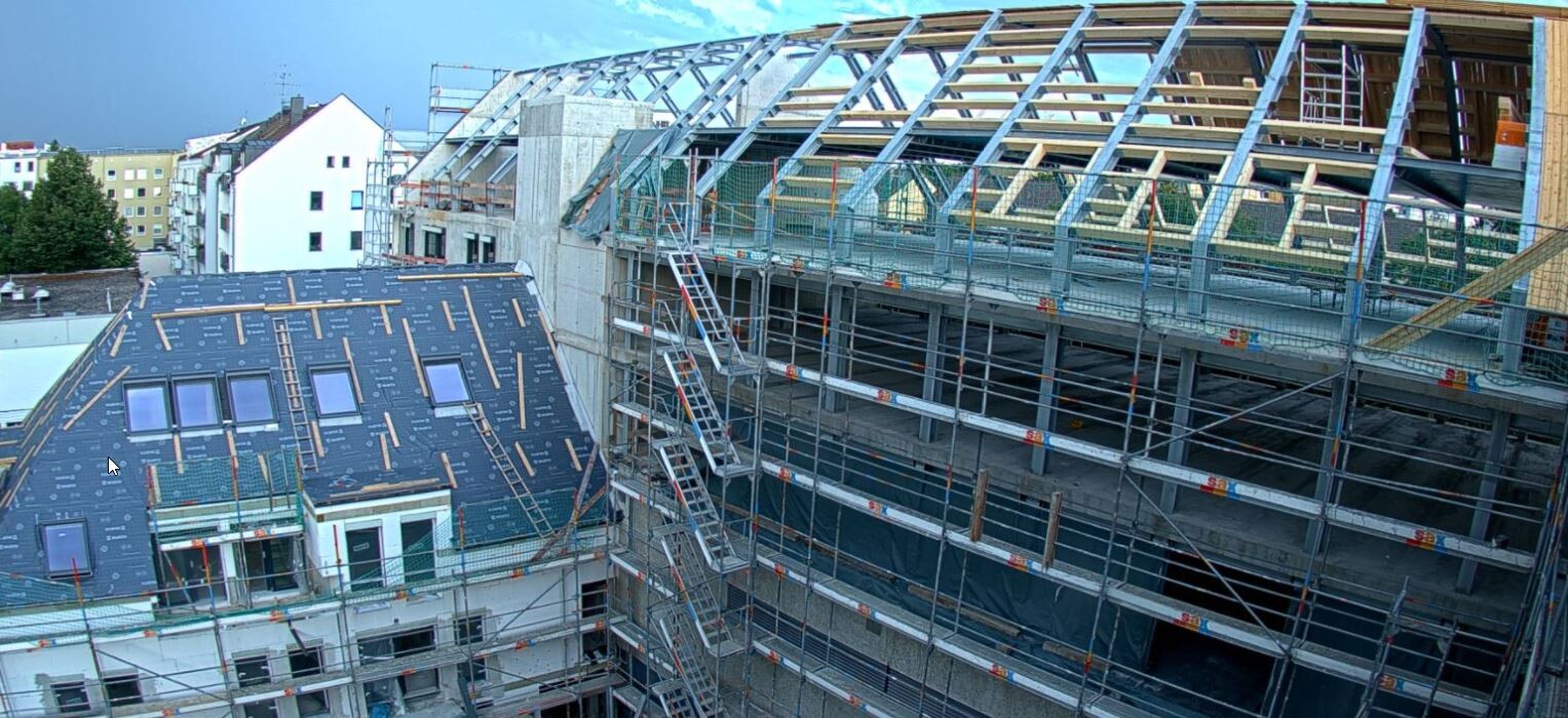

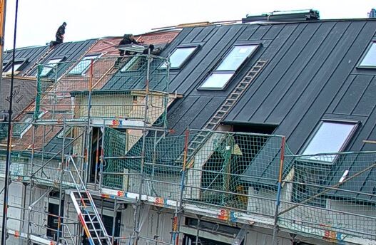

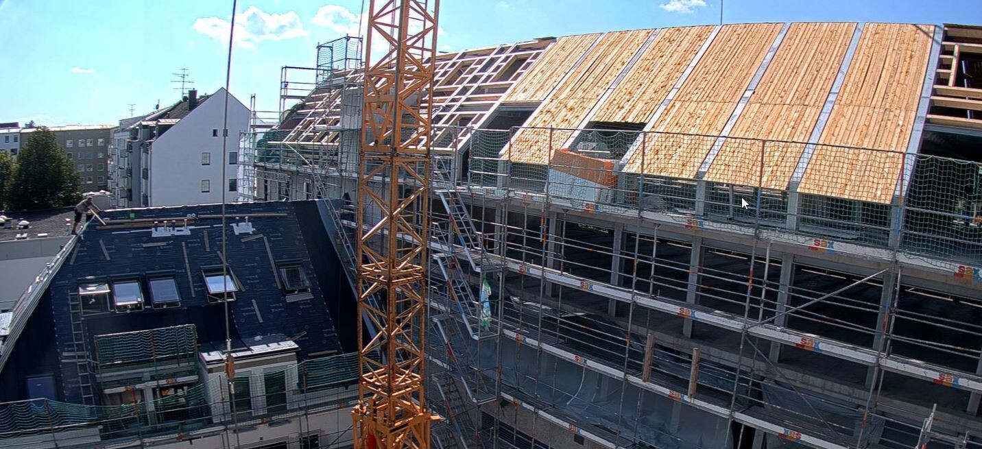

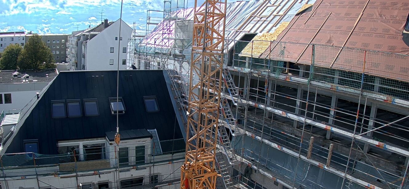

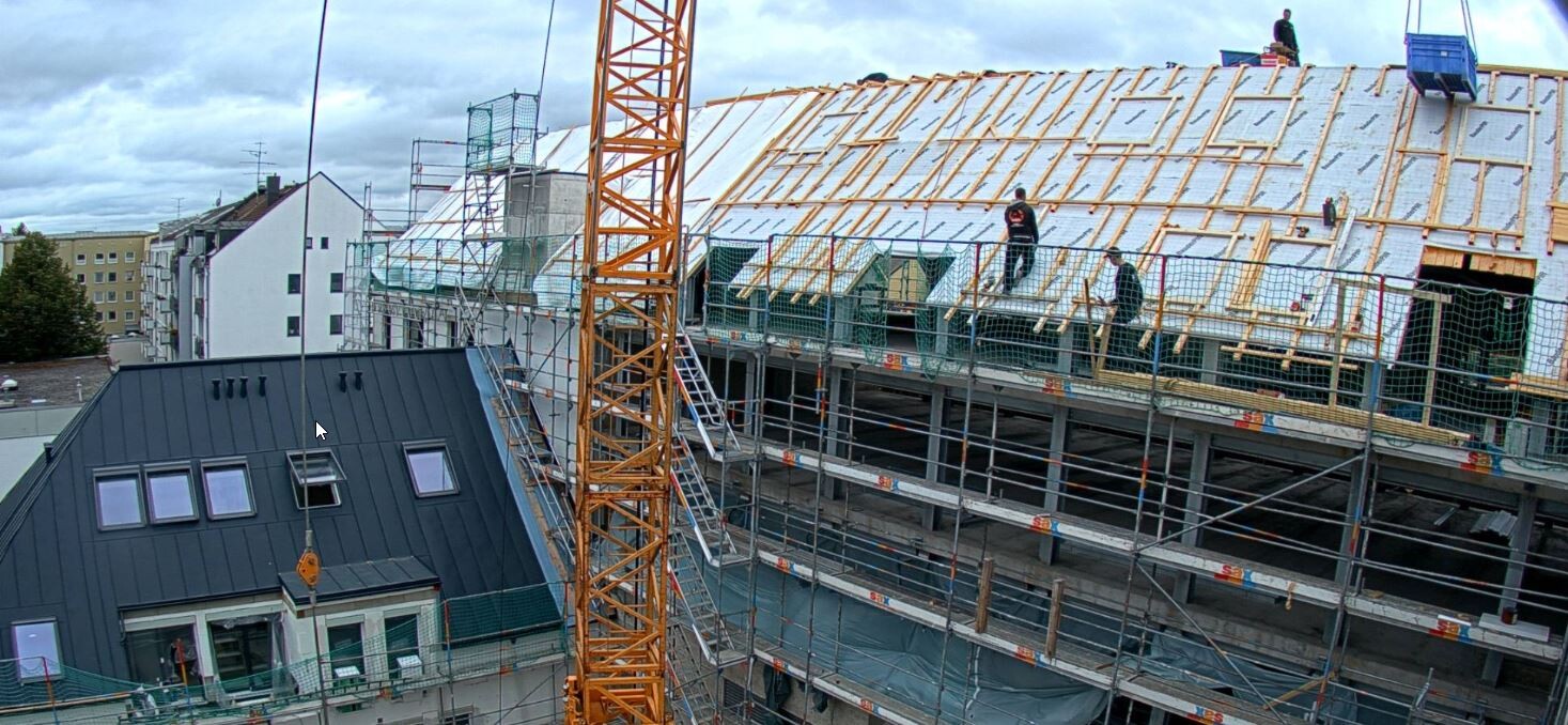

I have a question. In the construction description from the developer, it says that the house will have a roof made of sandwich panels. But when looking at the photos of the progress, no sandwich panels seem to be used.
At least, that’s how it looks to me. However, I’m really not an expert here. So my question is, can someone tell me what the roof structure is called if it isn’t made of sandwich panels? Or could it still be considered a type of sandwich construction?
Question 2: Does this look correct?

Mehrstöckiges Gebäude im Bau mit Gerüsten, Dachkonstruktion aus Holzrahmen und Bauzubehör.
Baustelle mit gelbem Kran, Gerüstbau und Holz-Dachkonstruktion, Arbeiter sichtbar
Bauarbeiter montieren Dachkonstruktion auf einer Baustelle mit Gerüst und Kran im Vordergrund.
Baustelle mit Kran, Gerüst und Dacharbeiten an mehrstöckigem Gebäudekomplex
Baustelle: mehrstöckiges Gebäude mit Gerüst, Kran und Dacharbeiten; Arbeiter auf dem Dach.
Baustelle mit Gerüst, orange Turmkran, Dachfenstern und Bauarbeiten auf Etagen
Mehrstöckiges Gebäude mit dunklem Metall-Dach, Bauarbeiter arbeiten auf dem Gerüst.

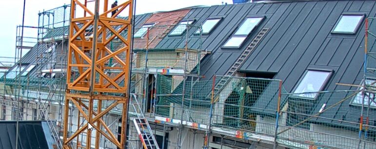

So the execution is probably okay.

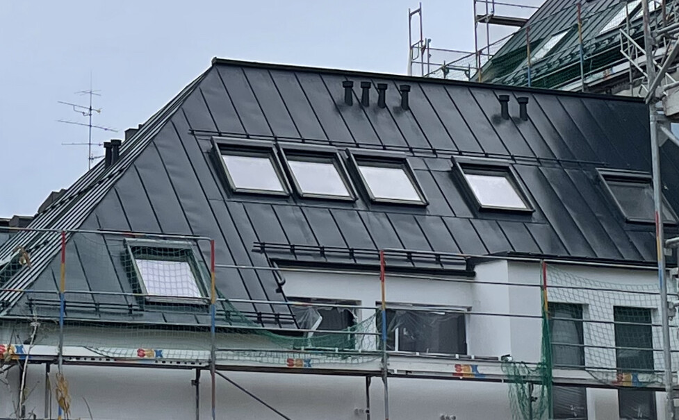

But should/is it allowed for the roof to have waves and dents like on the side extension?
That doesn't look very good. I hope it won't cause problems later on...
Slanted, dark metal roof with three roof windows; scaffolding and nets at the construction site.
hampshire
9 Dec 2021 20:12
The "Dellige" doesn’t look very good; I would like to discuss that. I am okay with the material.
OWLer9 Dec 2021 21:17
As a sandwich panel, I only know products like bondal from TKSE. However, in my opinion, it is basically just something like two layers of 0.5mm (0.02 inches) sheet metal with a film in between. To a layperson—especially from a distance—it looks like ordinary sheet metal.
Malunga
9 Dec 2021 21:43
johannMuc schrieb:
So the execution is probably fine.
But should/is the roof allowed to have such waves and dents like on the side building?
Because it doesn’t look very good. I’m just worried this might cause problems later on…
Personally, I’d say that’s not how it’s supposed to be.
We will also have a metal roof installed, but so far I haven’t seen any picture or brochure where it turned out like that.
HilfeHilfe
10 Dec 2021 06:12
johannMuc schrieb:
So the installation is probably fine. But should/is the roof allowed to have such waves and dents like on the side extension? Because that doesn’t look very good. I’m just worried it might cause problems later on…
It looks like the panels have been pressed together.
Visually unappealing.
tomtom7910 Dec 2021 08:51
And now it is winter; in summer, the metal will expand even more.
But maybe this is normal.
