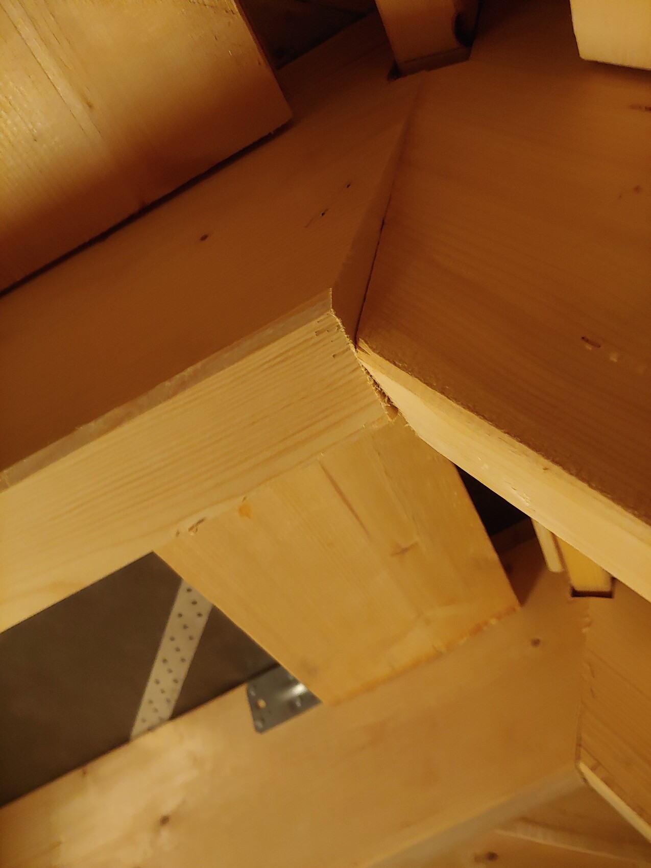

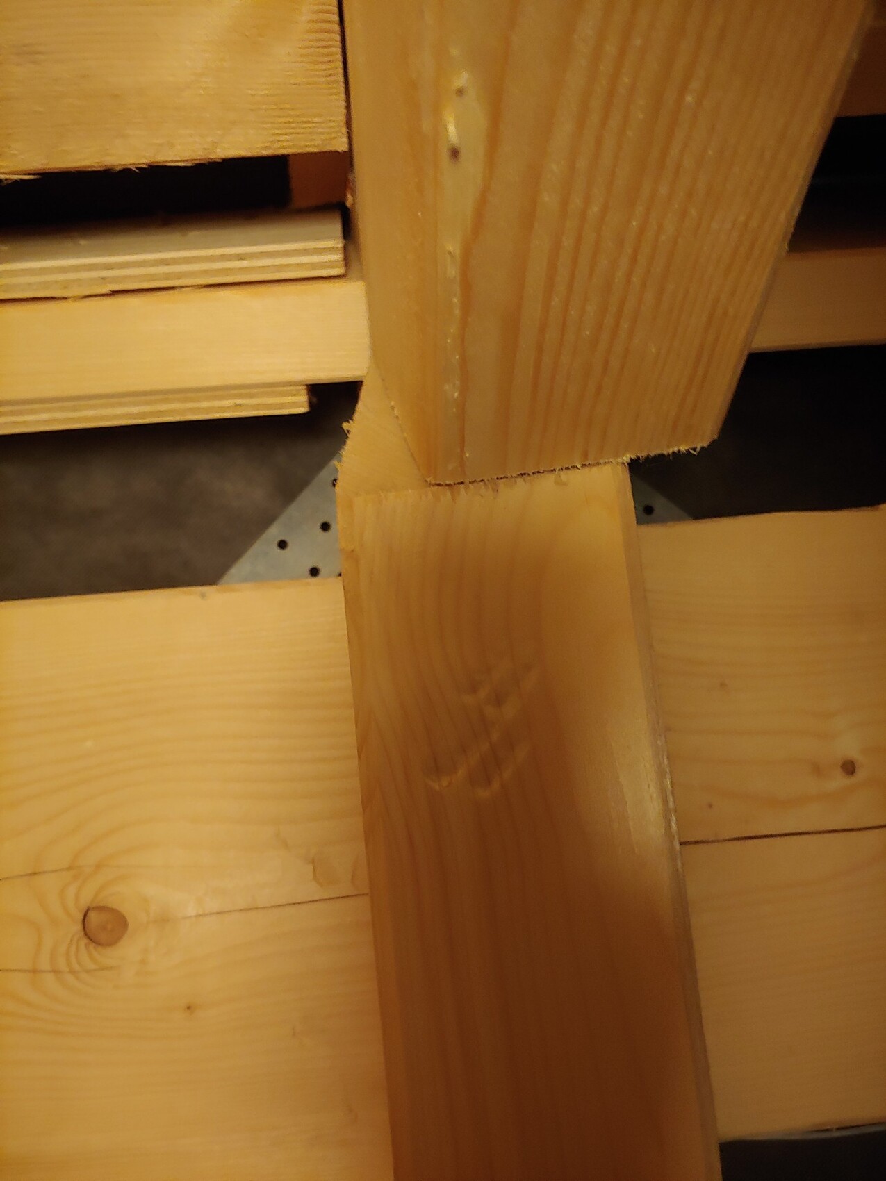

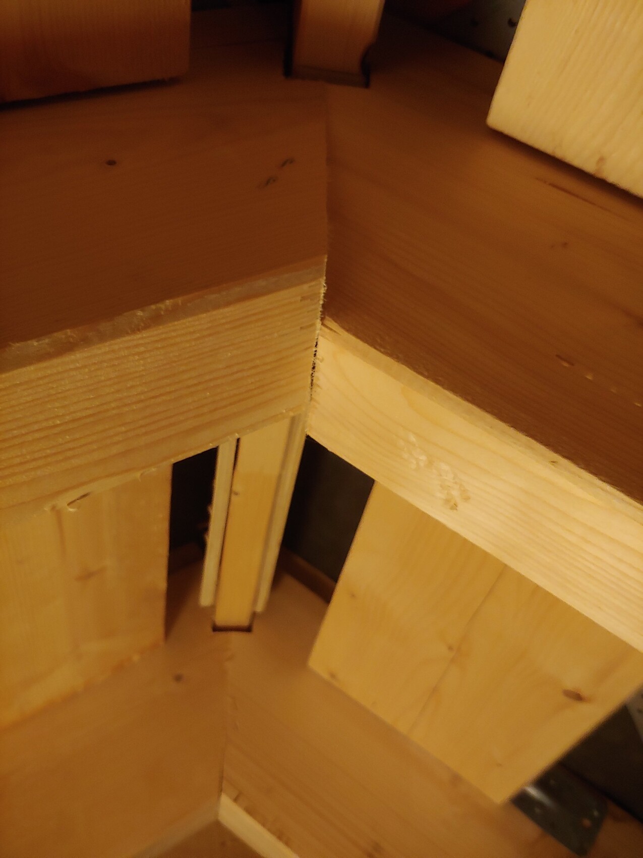

Two months ago, my family bought a used prefabricated house (built in 2018), and we have now noticed some very unprofessional work in the attic. At least, that’s how it appears to us (unfortunately, we don’t have much construction knowledge).
I am attaching a few pictures related to this.
What do you think? Does it really look quite uneven? Could this negatively affect the long-term structural stability? And if so, would this be considered a defect for which the homeowner has up to five years to report to the construction company and request repairs?

hampshire22 Mar 2021 17:00This beam is crooked, that’s not an illusion. Whether it was poorly installed, incorrectly shaped during prefabrication, or the wood warped due to the long time between delivery and construction – who knows, all of this is possible. If it were just one beam, I wouldn’t have structural concerns. It’s definitely not aesthetically pleasing, though.

knalltüte29 Mar 2021 22:27I took a closer look at the pictures (an additional photo from a greater distance would be even better). The ridge beam appears to be scarf jointed (the two laminated timber pieces), for whatever reason. Was there no suitable piece of KVH available? Extremely long roof structure. Who joints ridge beams in sections? No, no, no 🙄
Also, in my opinion, a metal bracket does not belong up there in a properly assembled roof frame.
As a solution, if you have doubts about the structural performance of the opposing rafters, a retrofitted, sufficiently strong (thick) collar beam might help. That could potentially straighten the rafters. However, a master carpenter would certainly be able to provide a better answer. But if I show this to someone (for example, the person who helped build our house), they always start swearing at such poor workmanship :p
