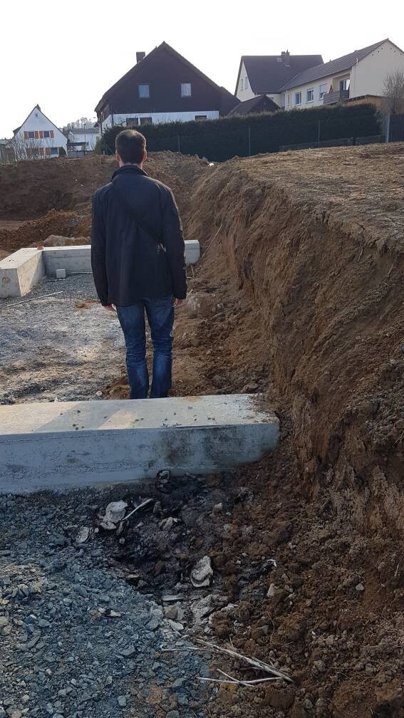

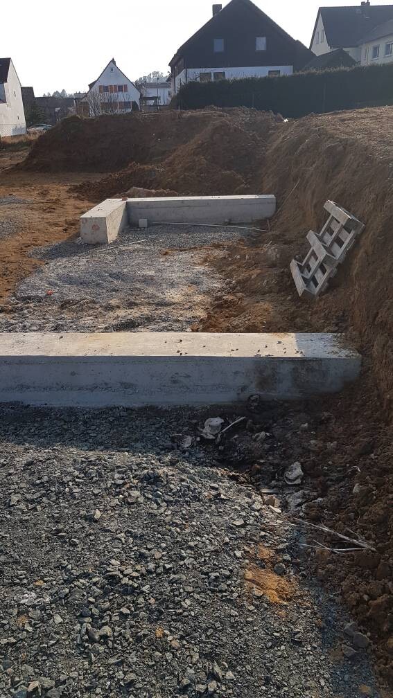

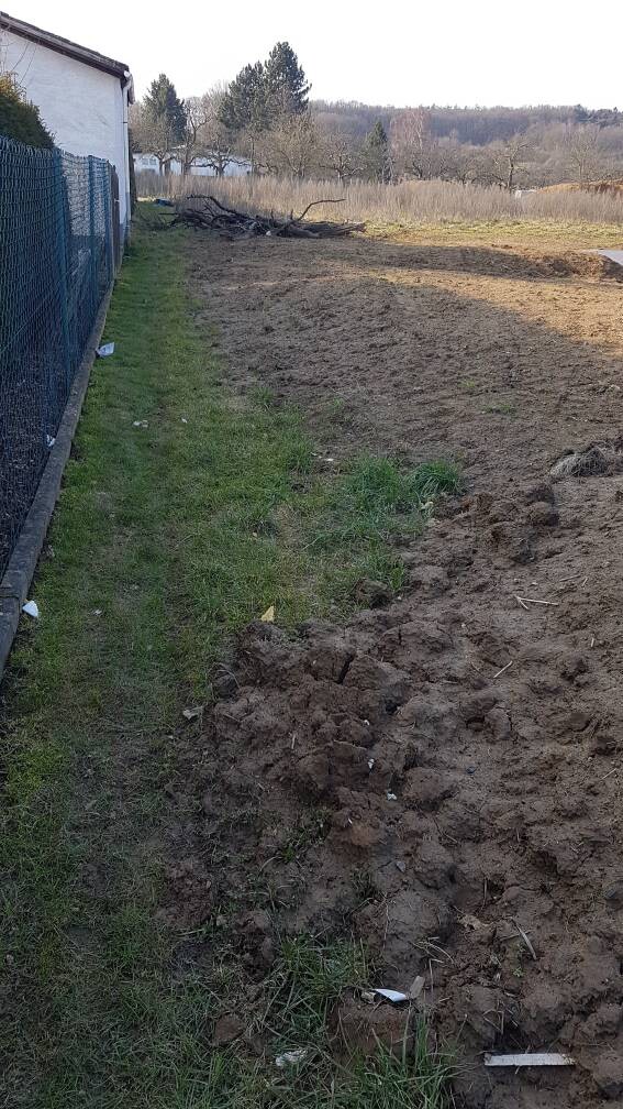

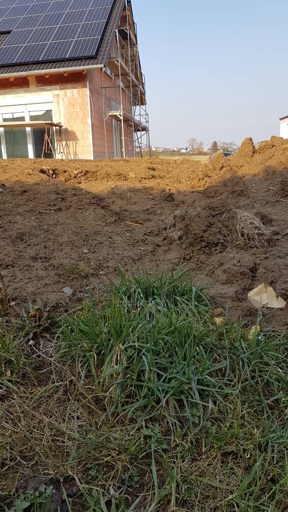

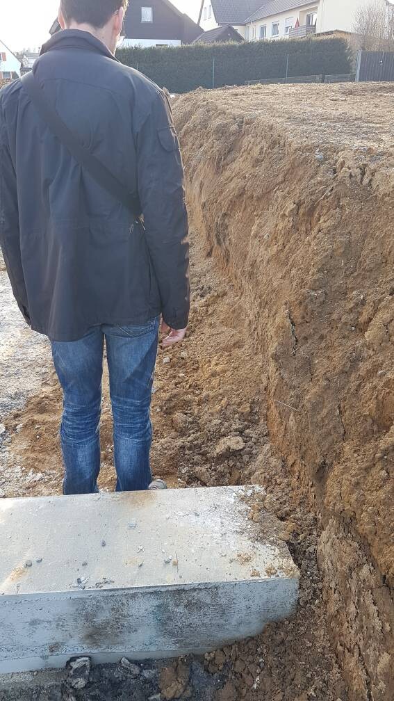

Here are some pictures from today. At knee height, a grid is visible; we are considering whether this was the level during the construction of the concrete slab.

Nordlys
25 Mar 2018 19:01
Well, if he hasn’t filled it in, I’ll eat my hat. You just absolutely need to get back to the original level, then he will have to cover the cost of the containment alone.
Caspar2020
25 Mar 2018 19:02
So the first and now the last pictures suggest that you have gone down 30cm (12 inches) and it has also gone up 30cm (12 inches) at the same time...
