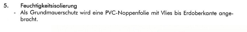

exto1791
31 Aug 2021 14:16
A dimpled membrane is still included in our construction and performance specifications, so it will also be installed:
Moisture protection: PVC dimpled sheet with fleece up to ground level as foundation wall protection.
