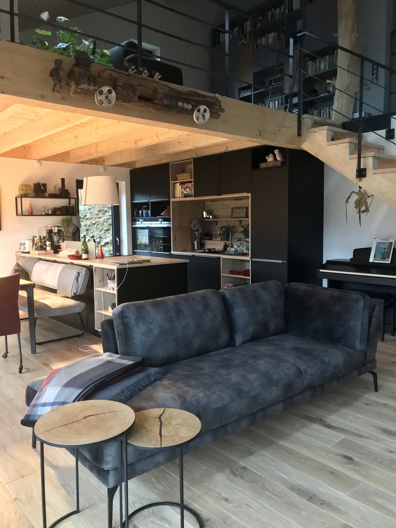

28sqm (300 sq ft) living and dining area is really quite small; you’ll notice it sooner or later. I don’t agree with this statement. It only feels cramped if you are a "wall unit or entertainment center enthusiast," need a large "sectional sofa," and absolutely want to make a TV the dominant feature of the room. With 28sqm (300 sq ft), you can create a great space.
We have accommodated a kitchen, dining area for 8 people (without extending the table), kitchen stove with a seating bench, chaise lounge, and straight staircase within a 50sqm (540 sq ft) area. It looks spacious and has no tight spots.
