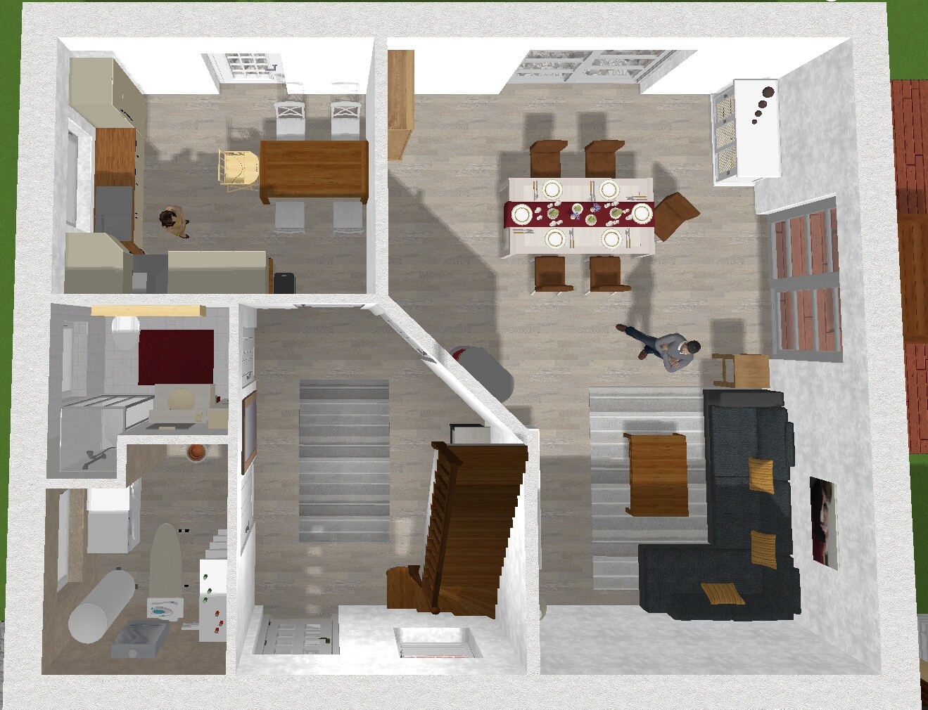

Today, the architecture department sent me the first draft of the house type we discussed. The more we look at the floor plans, the less certain we feel.
So here is the question: We have two house types from the company to choose from and are undecided because with the smaller house, adding an outbuilding (e.g., behind the carport) might be financially possible sooner or later (about 20m2 (215 sq ft)).
About the types:
House A
Single-family house, gable roof, brick facade, approximately 125m2 (1,345 sq ft), 5 rooms
House B
Single-family house, gable roof, brick facade, approximately 114m2 (1,227 sq ft), 4 rooms
Both houses are constructed with solid masonry and some extras (roller shutters, underfloor heating, walk-in shower in the guest bathroom, etc.) at a cost of about 1700€/m2 (approximately $158 per sq ft).
We currently have one child (about 1 1/2 years old), and a second child is neither planned nor ruled out.
I am a passionate musician and occasionally enjoy a half weekend gaming session on the PC. So an outbuilding like the one described actually makes more sense—maybe it could also be used as a party room?! Also, my wife prefers the layout of the smaller house significantly more.
I’m curious to hear the opinion of the “collective.”

Micha858920 Jan 2020 06:35I have only posted the ground floor plans because the upper floors of both houses are exactly the same. That means 4 rooms of identical size, each with a bathroom. The only difference is the length of the rooms, as House A is almost 1 meter (3 feet) longer.

Micha858920 Jan 2020 07:58I haven’t even considered the topic of basements yet because, to my knowledge, they are supposed to cost €70,000 (approximately $75,000 USD) or more?!
Micha858920 Jan 2020 08:05haydee schrieb:
Draw your existing or desired furniture to scale.
With the right furniture, the rooms no longer feel spacious. I already did that last night to show it to my wife, and I am aware that 112 m² (1,205 sq ft) is not the size of a luxury city house, but visually there is still space except for the utility room (furniture was scaled to match our current, existing furniture).
