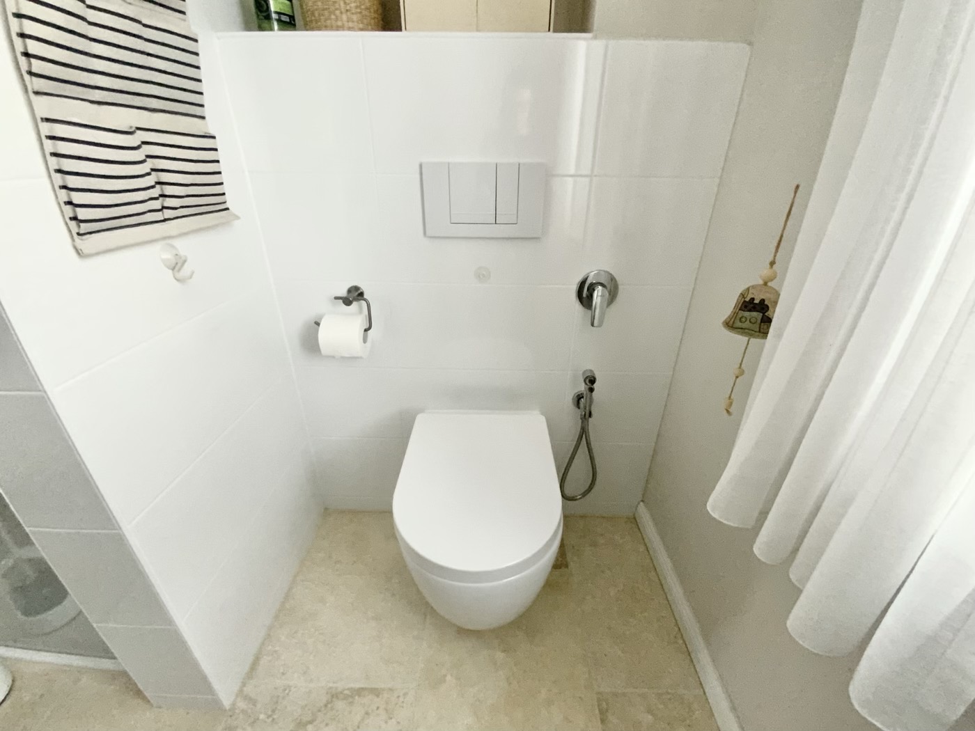

When building our new home, we had a water connection installed directly to the toilet. I love the bidet function, and it works perfectly for "front and back." We do have warm water available, but I often use just the cold water. I don't find it unattractive at all. It’s also great for keeping the toilet clean. Best regards
R
Renovierer31 Jan 2026 11:42Thanks, Steffi, it really does look quite nice at your place. However, I imagine it to be somehow more complicated and prone to dripping compared to an integrated solution. On the other hand, it will definitely last a long time, and with the toilet and toilet seat, you have complete freedom. I’ll also show this to my wife – maybe it will come up as a third option after all...
