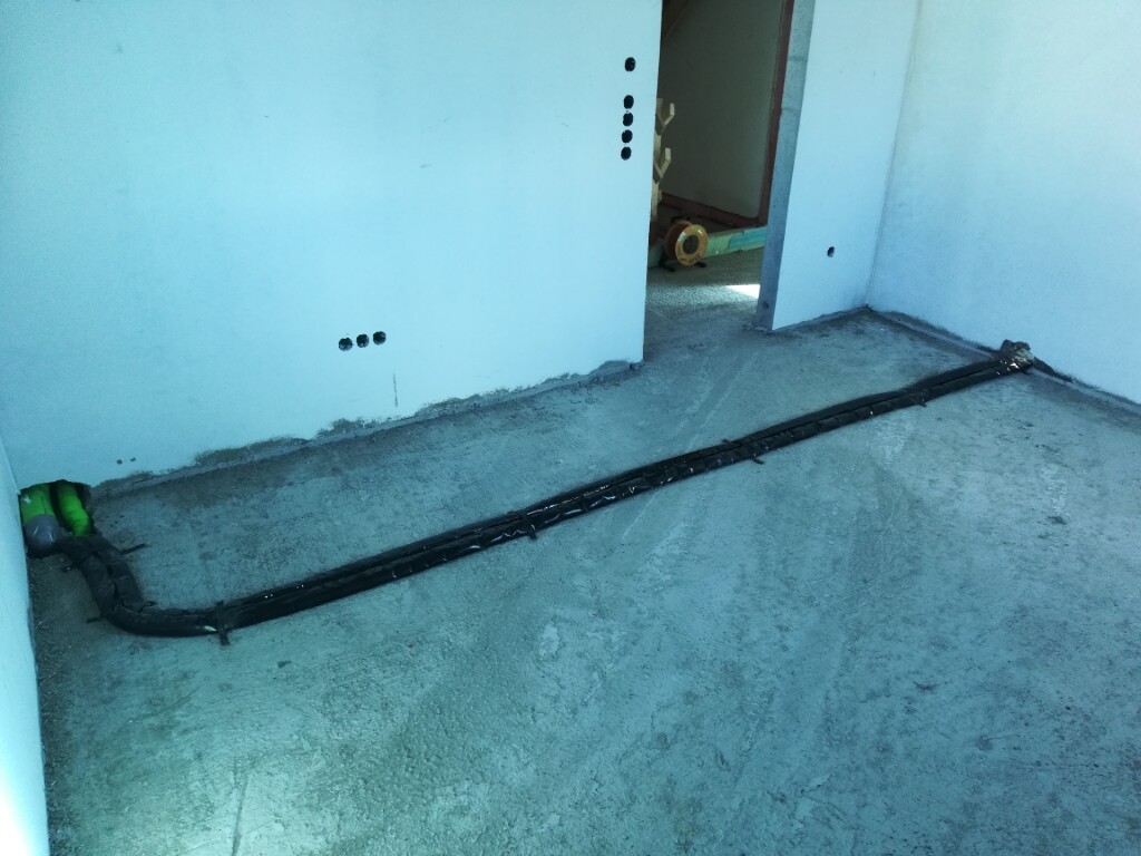

It could also be that the heating loops for the other rooms run through the bedroom? Where is the manifold located? Unfortunately, this is sometimes done incorrectly. That would be really bad. Good point, thanks. That is actually the case. The "supply line" for the manifold on the upper floor runs right across the bedroom. But it’s under the insulation for the screed and, from a floor plan perspective, it wouldn’t have been possible otherwise. I need to measure whether the floor is warmer there than in other parts of the bedroom. That would at least be a small explanation:

I will experiment a bit with the temperatures of the other rooms on the upper floor; maybe that will help a little. The bedroom is also directly adjacent to the bathroom, where the temperature is naturally the highest…
