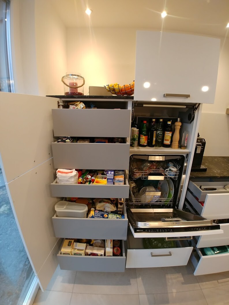

And about leaving out the pantry: I would only consider that as a last resort. I really like a cool, separate pantry, even though very few have one nowadays. Especially with a stove in the open living area.I’m afraid I have to bring you back to reality—your pantry would only be separate in name. It wouldn’t be cool at all. The room will be just as warm as the rest of the house; significant temperature differences are neither expected nor usually achievable with modern construction methods.
And if you add a fridge or freezer in there, it will probably become one of the warmest rooms in the building...
At first, we also really wanted a pantry, but we gave up on the idea and instead integrated a storage cabinet into the kitchen. You probably can’t store supplies more compactly than that.
