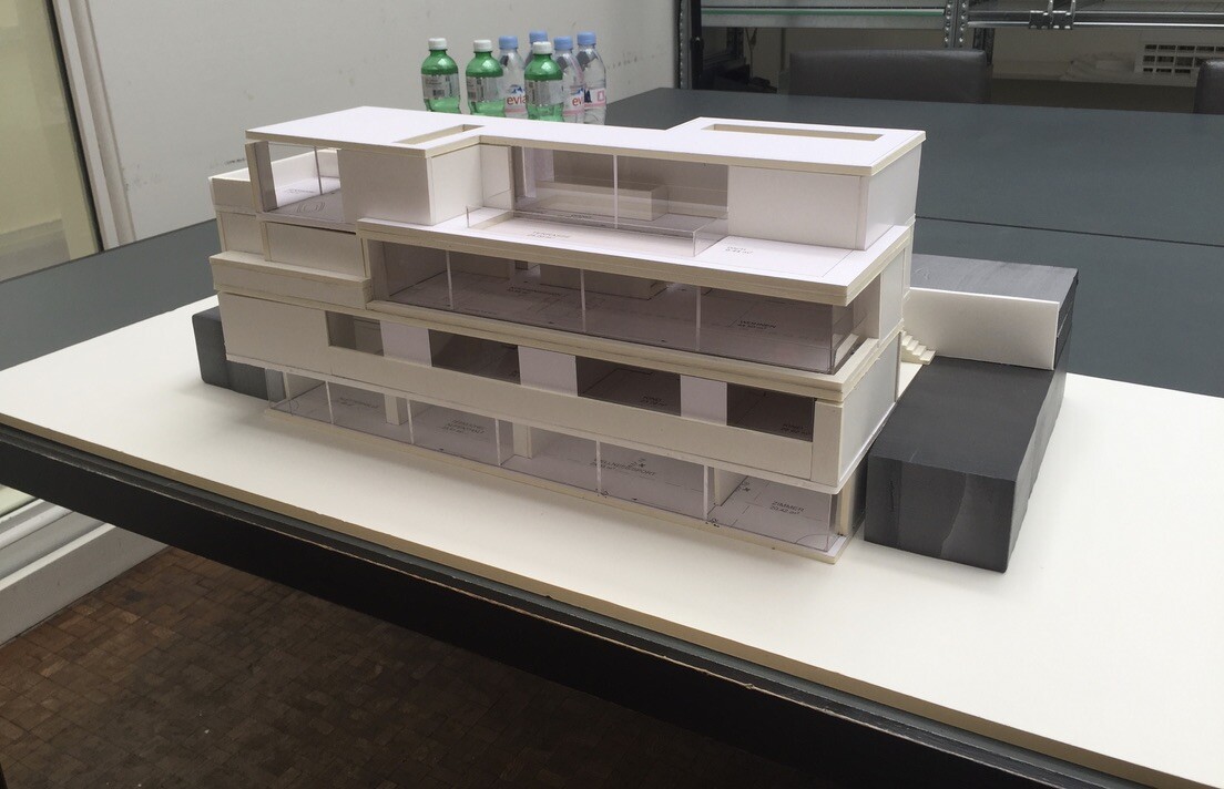

Architectural model of a modern, multi-story white building with glass facades.

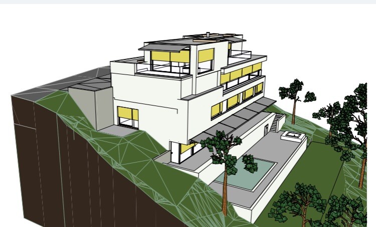

3D architectural model of a modern villa on a slope with terraces and trees

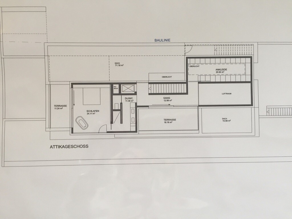

Attic floor plan: bedroom, walk-in closet, shower/WC, hallway, and terrace.

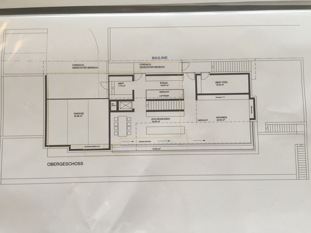

Upper floor plan: garage, living area, kitchen/dining area, storage rooms, and stairs.

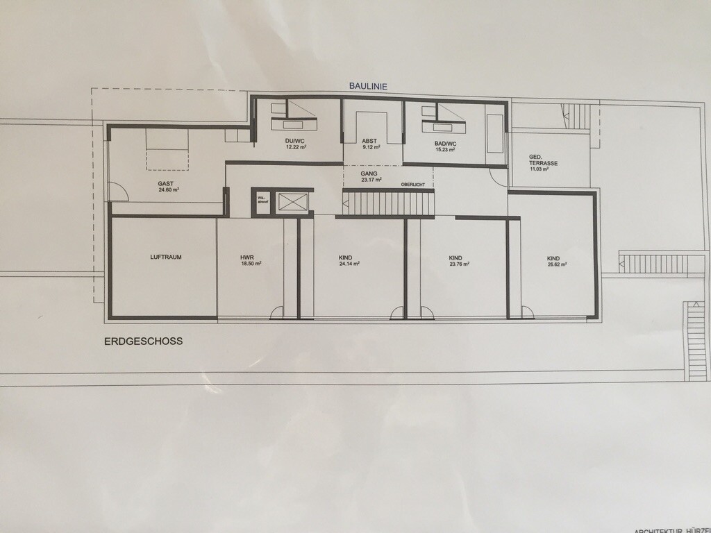

Ground floor plan: guest room, three children’s bedrooms, open space, utility room, bathroom/WC, terrace.

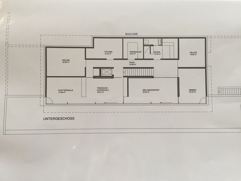

Basement floor plan with cellars, technical room, sauna, wellness area, and room

I really like the consistent separation of the floors. Despite the generous open space, the attic floor offers a good retreat area—also helped by the bathroom acting as a “sound barrier.” With small children, my wife would have found the distance to them inconvenient, but I wouldn’t. For older children, it’s a blessing.
Placing the shared living area centrally on the entrance level is a smart choice. Below that, children and guests have a comfortable space—it creates an additional wing that is especially suitable for teenagers, providing a private area for everyone. The spa in the lower level and the idea of having a climbing wall add a wonderful personal touch and enhance quality of life.

It’s a relief that you decided not to implement the oversized bottle sculptures shown in the first picture.

@Mellina is it going to be a stainless steel pool?

The skylight is already included in the model. Is that a challenge feature in the climbing gym, which in the facade only steps back at about knee wall height?
The climbing gym is actually a multipurpose room / gym for the kids. The setback is an architect’s idea to make the facade look nice or something like that...
