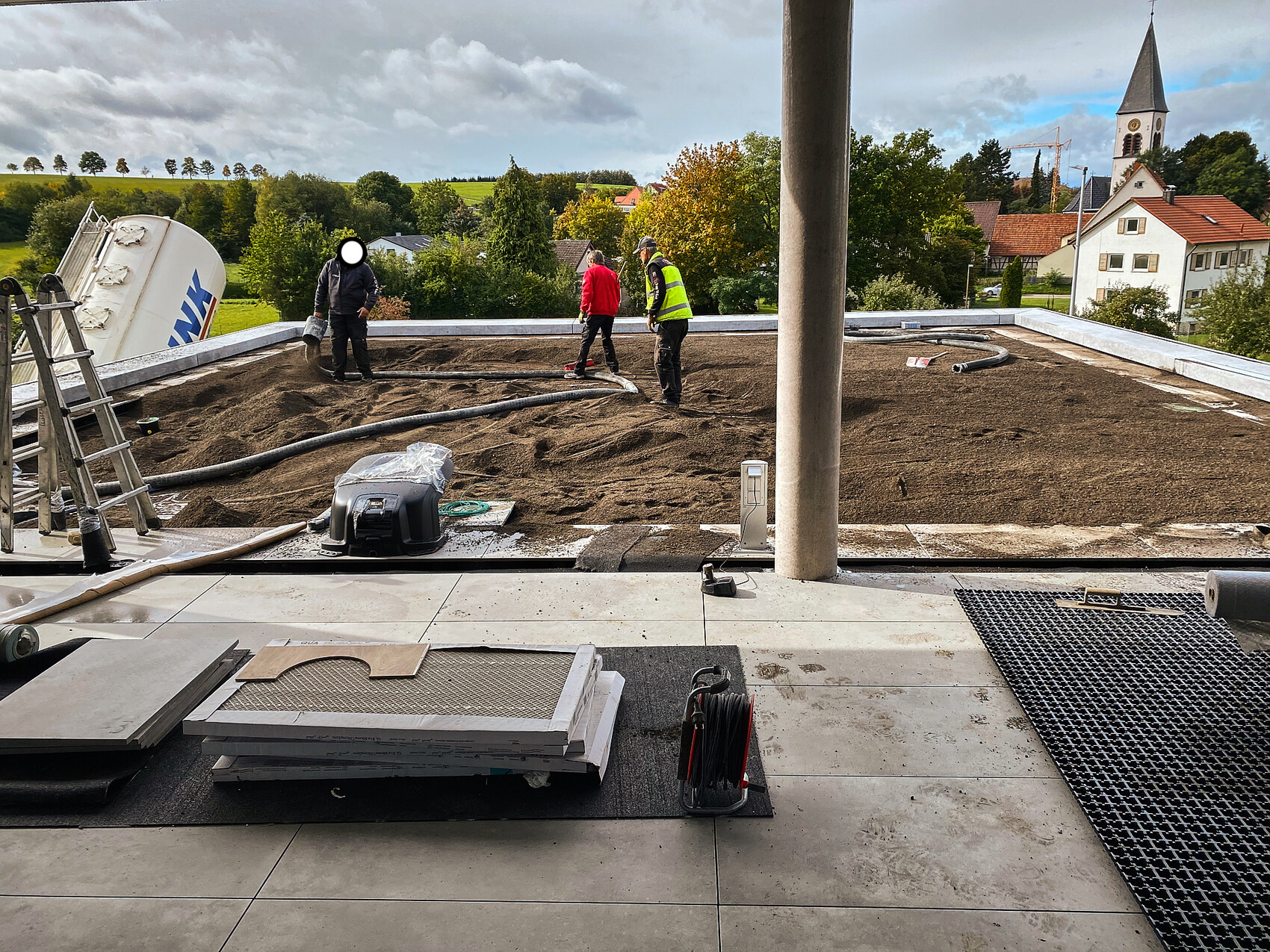

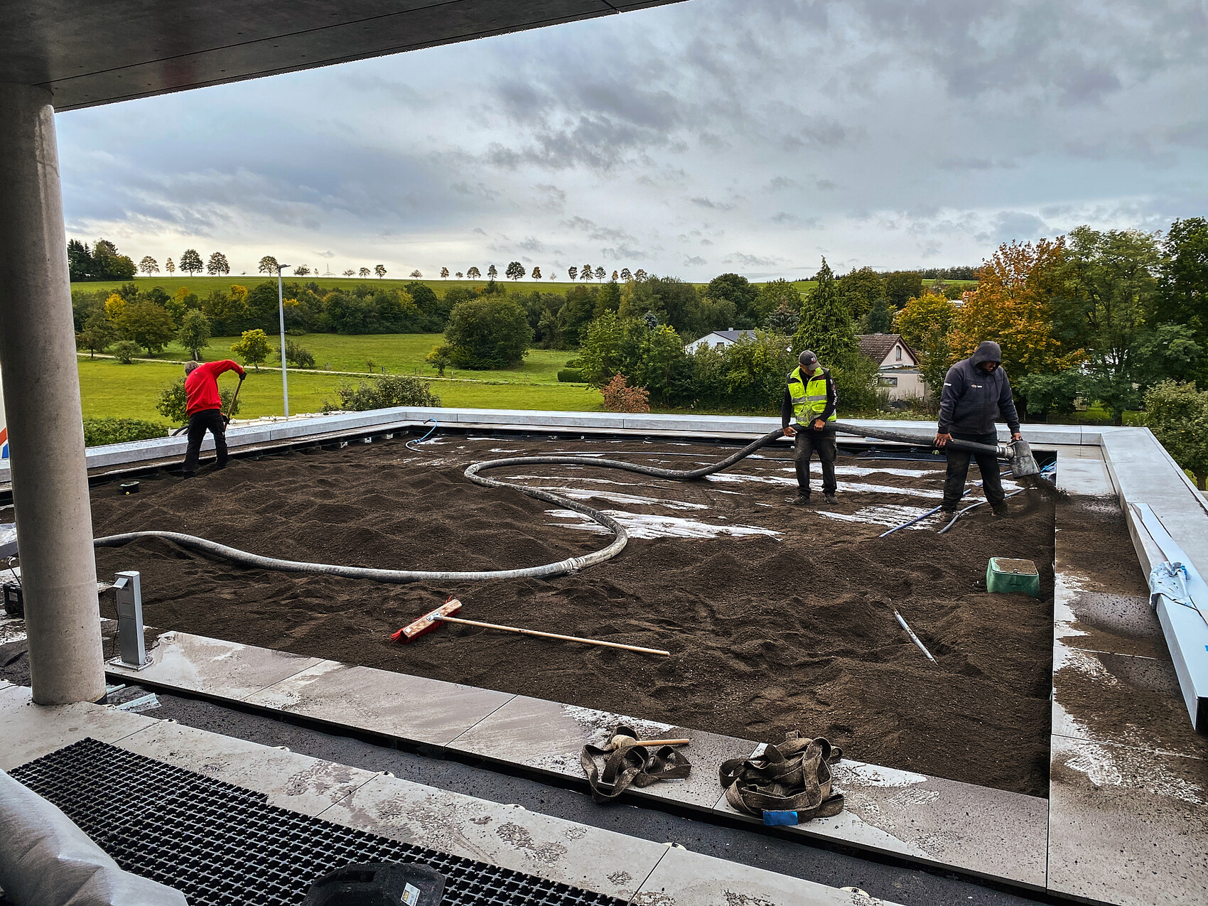

The garage roof was a very simple task regarding irrigation (small, rectangular...).
Laying it will never be as easy as with a new installation. No digging was needed at all.
The supply line is DN40 to the 4-way manifold. Branch lines are DN32.
- Lawn sprinklers (Hunter PRS40 + MP3000 rotor head)
- one water outlet (32mm (1 1/4 inch) connection/passage)
- two connections for drip irrigation (in case we want to plant something later)
If it keeps going like this, I can start sowing tomorrow
