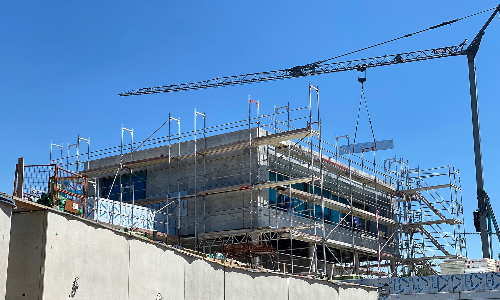

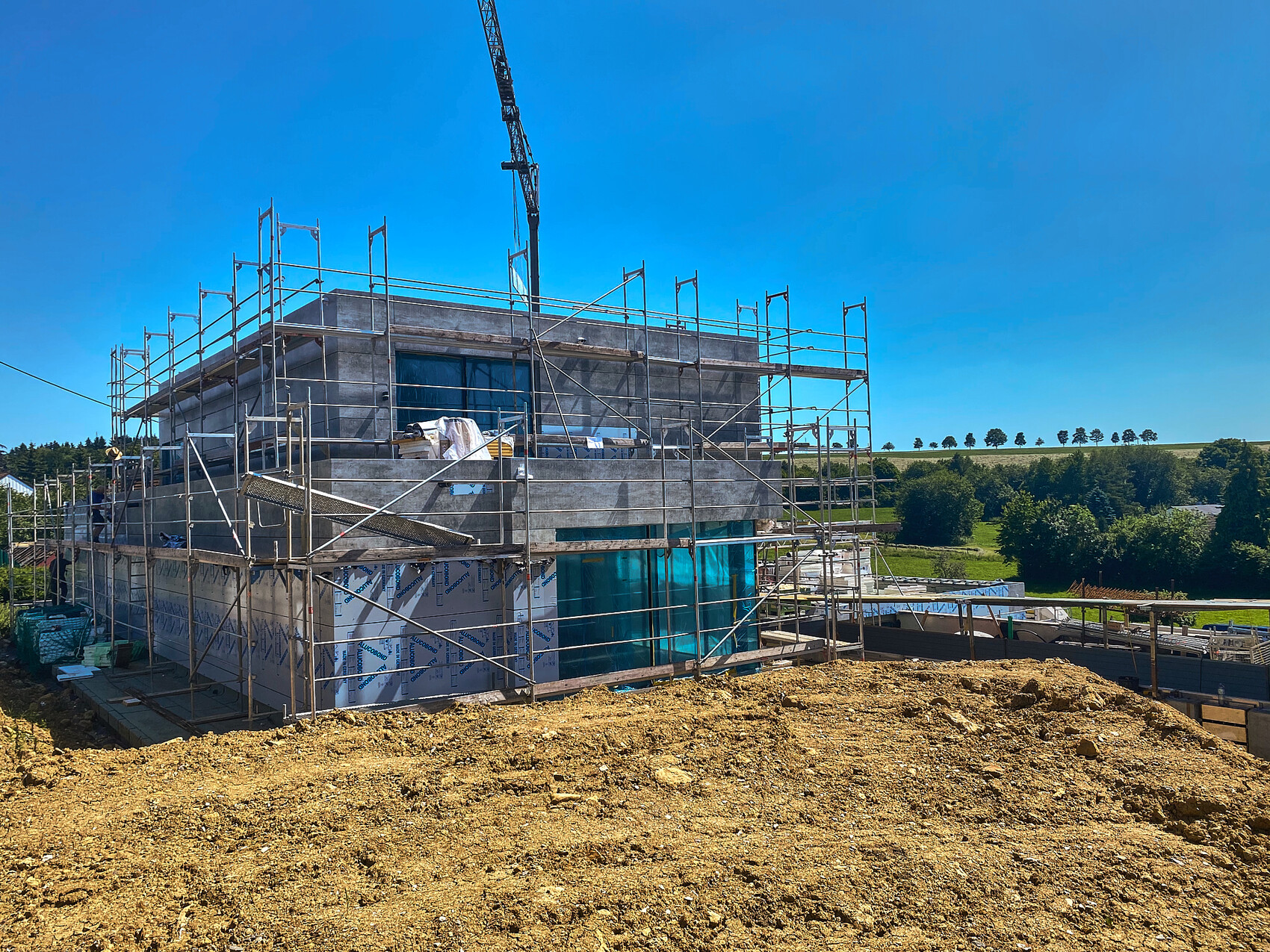

The facade is a ventilated and mounted cladding made of AluCobond panels.
Nowadays available in almost any design. When properly installed, it can be bent around corners, etc.
It is also very low-maintenance and easy to clean. Just wash it down.
Our wall construction (from inside to outside) consists of concrete, insulation, an air gap, and the facade.
Due to several factors, we were unable to build with concrete walls with cavity insulation as originally planned. Since we also wanted a concrete look on the exterior, we opted for this solution. It has several advantages.
We spent a lot of time working on the joint pattern to ensure it is consistent. The offsets made it quite challenging.
