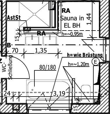

We have a large 80x180 cm (31x71 inch) bathtub in our bathroom. The bathtub is placed in front of a window with a sill height of 69.5 cm (27.4 inches) above the finished floor level. The tub itself is about 60 cm (24 inches) high. It is installed on a bathtub support frame set on the finished floor. The construction manager insists on this because I mentioned that the tub feels too high for us and we would prefer to place it directly on the rough floor. He says that it must be placed on the finished floor to prevent water damage from penetrating the building structure.
I continued planning and realized that there will be almost no space left for the faucet fittings, as there are only a few centimeters between the top edge of the bathtub and the window sill height. So, the faucet cannot be installed where it is planned in the execution drawings.

This combination has actually been fixed since February 2019 and was finalized at the latest during the material selection in August 2019. In the construction drawings from September 2019, at least the wastewater pipes were shown, and the planning department should have noticed that there was no space for the faucet fitting.

Unfortunately not. The planning is already set, and the bathtub in front of the window makes the most sense due to the low windowsill height. Raising the windowsill would probably only be possible by lowering the windows. The windows measure 1.76 x 0.76 meters (5 ft 9 in x 2 ft 6 in). We also had to remove the roller shutters because of the ceiling height/roof. With a lower knee wall, I would probably have planned a roof window above the bathtub.
