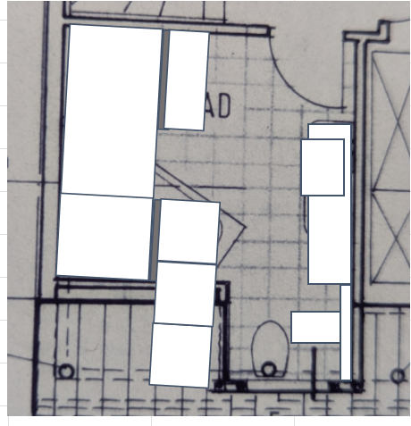

We want to renovate our bathroom and are currently considering how to make the best use of the space. There is a sloping ceiling that limits the usable area somewhat. The door opens inward and cannot be changed.
I have attached an initial sketch. The toilet needs to be positioned closer to the slope, but I am unsure about the minimum required height there.
Do you have any suggestions for improvement?

Nicci19 schrieb:
I'm trying out the program now as well, but it’s challenging ????
Actually, it’s one of the simplest compact programs 🙂
You can take screenshots/photos on the left side and save them to your hard drive.
Otherwise, I usually use my own quick keyboard shortcut “Apple F4” (or something similar). On PC, Snipping Tool works well.
For sloped ceilings, it calculates and displays the slope differently: it always shows the slope at the ceiling, not at 2 meters (about 6.6 feet).
A cabinet like yours will be tight and probably won’t fit, because the shower is built higher than a person’s height. A shower needs to be at least 2.20 m (7 feet 3 inches) tall.

Here is another attempt.

Thanks, but honestly, I don't really understand the plan.
17 Mar 2026 16:20
Nicci19 schrieb:
Thanks, but to be honest, I don’t really understand the plan?
Me neither 😀
