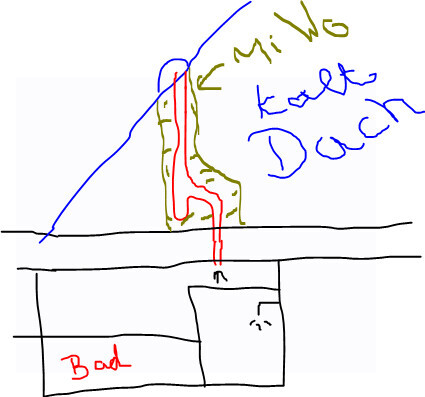

We already had the problem in March that condensate was dripping from the bathroom exhaust air duct. The pipe passes through the vapor barrier layer and goes through the uninsulated roof to the outside. It has a bend and includes a "condensate trap" – whether this makes sense or not is unclear.
Last time, the trap was full. The solution was to empty it and, of course, properly insulate the uninsulated pipe on all sides (which the carpenter did).
Now the problem is happening again. From a physical point of view, I would say just wrap more mineral wool around the pipe – or are there better solutions?

BeHaElJa schrieb:It was correct to consider the condensate trap in the planning phase. However, the chosen solution does not work. Based on your sketch, my guess is that the condensate trap is positioned too high.

Bieber081514 Nov 2016 14:14BeHaElJa schrieb:
Wouldn’t wastewater venting cause odors?Yes, exactly, that’s why you shouldn’t combine the room’s exhaust air with the ventilation of the wastewater pipe.BeHaElJa schrieb:
I think it just has to be airtight...Airtight and exhaust air are somewhat contradictory.You won’t be able to completely and reliably prevent condensation (or wouldn’t want to: heated pipe). Therefore, the condensation must be properly drained. There are solutions for this. But it needs to be professionally planned, not here in the forum, nor casually between the site manager and carpenter.
