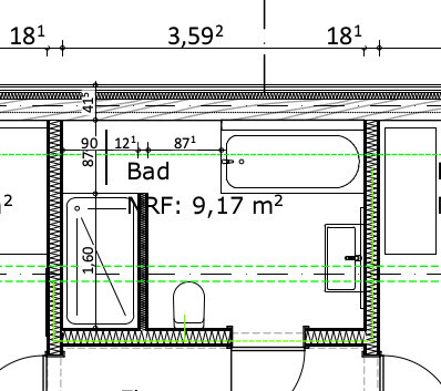

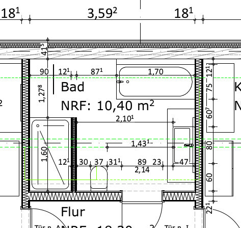

I have two floor plan options for the bathroom (each comes with different constraints elsewhere in the house, but that’s not the focus here). One option is a "small" bathroom, and the other is 40cm (16 inches) wider, so "large." Does anyone have a bathroom of a similar size? How do you find it? Is the larger bathroom simply more expensive and requires more cleaning, or does it provide significantly more comfort? Thanks.
2D bathroom floor plan with bathtub and toilet in floor plan drawing.
2D bathroom floor plan with bathtub, toilet, and hallway in a floor plan

This is the dashed green line!

Who came up with the idea to place the toilet in the middle of the house without a partition wall and without proper drainage?
Where does the wastewater go?
I don’t see any extra cleaning effort for one or two square meters (11 to 22 square feet) more.

I don’t see any added benefit in a larger floor plan. However, there is also no difference when cleaning, since it only means more floor area.

The question is also where the extra space will be taken from. I would prefer the slightly larger version, but not at the expense of a smaller children's room...

Sure. But a) you should mark it in the plans just like the drain, and b) having a drain in the middle of the house strikes me as risky. Any blockage below the slab or bend is, as the saying goes, a real pain.
To the original poster: my advice is to place toilets near the exterior wall, at least the waste pipe, and position the toilet as close as possible to it.
