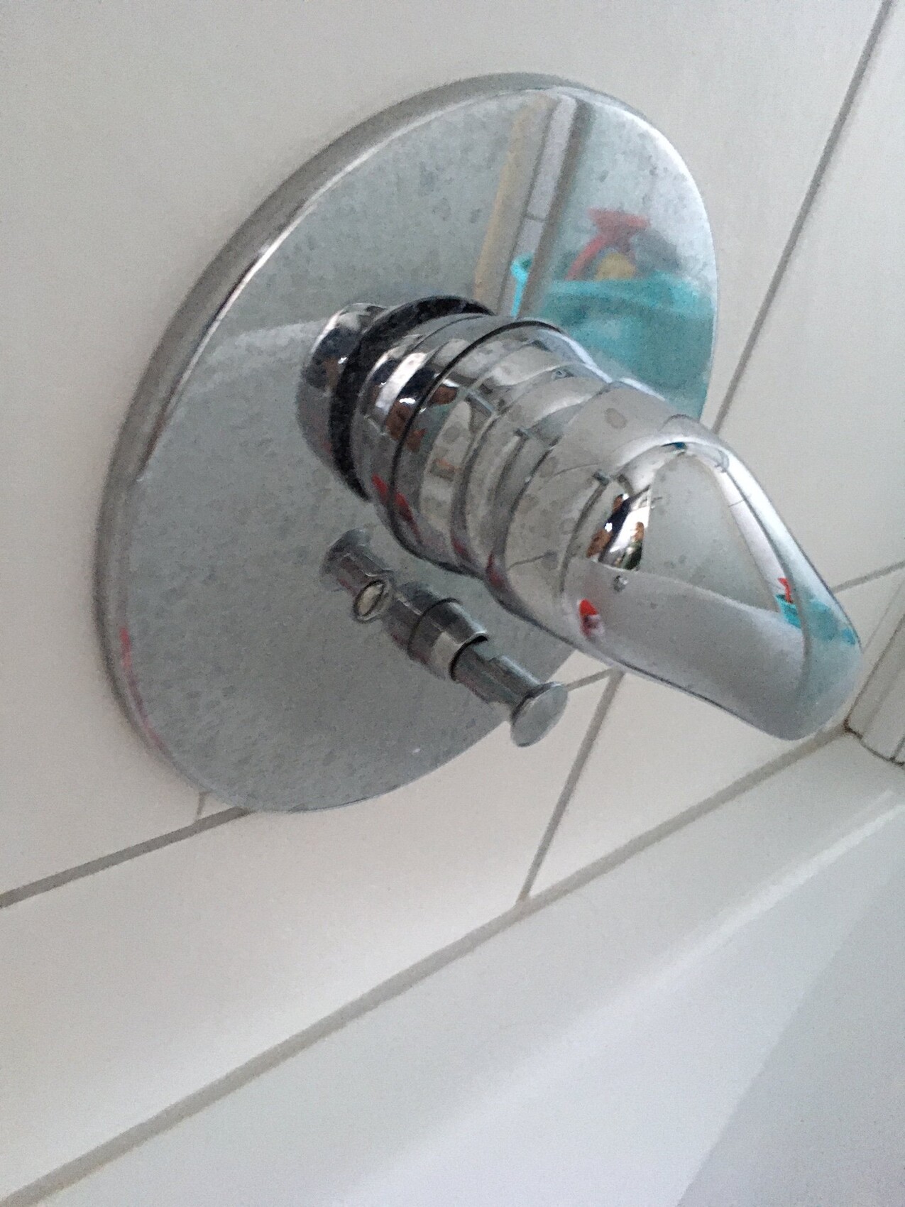

However, we noticed that the diverter in the concealed shower valve, which switches water flow between the showerhead and the bathtub spout, no longer works correctly. The diverter pin is located under the lever and is difficult to move or adjust. Also, when using the shower, water still flows from the bathtub spout.

A picture could help further.

I’m not sure if the diverter can be fixed, but the valve itself seems unusual. Ideally, we would like to replace it completely with a different one. Attached is a picture.
Chrome-colored shower valve handle on a round metal base plate in front of tiles.

Well, I’m confident I can replace the faucet myself. The main challenge is finding a suitable replacement, especially since it shouldn’t be the same model again.

Find out the exact model and then check what the manufacturer offers. The high-end/expensive ones either have a universal rough-in valve for all models (Hansgrohe) or use the same rough-in valve for a range of models. After 6 years, you might still be lucky and find other faucets that fit the valve. With DIY store products, however, you usually have little chance.
