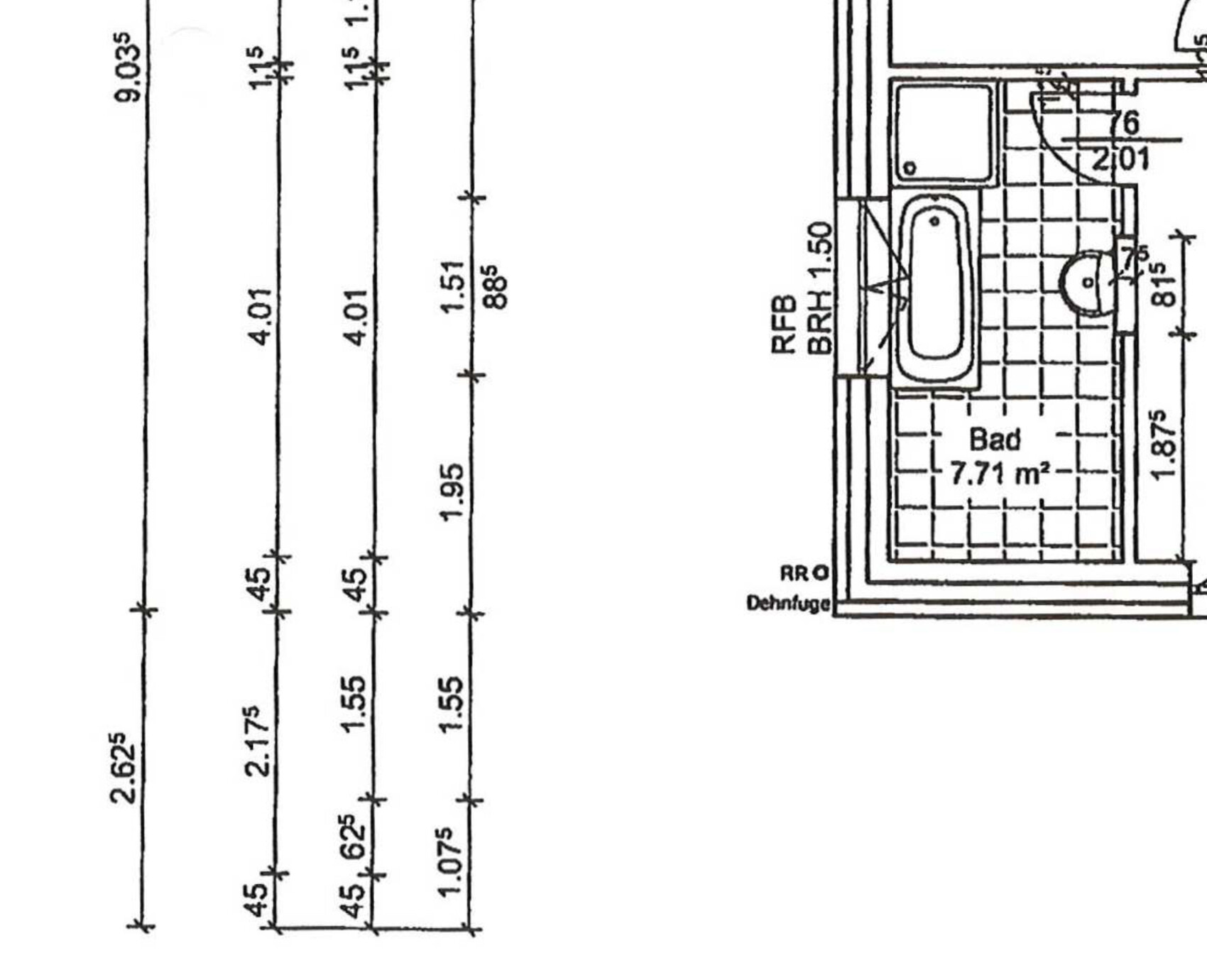

Hauwieneubau21 Apr 2021 17:07Hello everyone,
I’m considering buying a bungalow built in 2015, but the bathroom was very poorly designed:
The floor area is about 2m by 4m (6.5 ft by 13 ft). Unfortunately, there is no toilet planned here, but the plumbing connections are supposed to be located at the bottom left, in line with the bathtub (under the tiles). The sink is suitable for a guest toilet, but not for a main bathroom. In that area, the wall was built with 17.5cm (7 inches) calcium silicate blocks (I assume to accommodate the drain). All other walls are built with 11.5cm (4.5 inches) calcium silicate blocks.
My idea is to install a toilet and a walk-in shower along the lower short side, separated by a frosted glass partition. The room width of 1.93m (6.3 ft) should just allow for this, right? The bathtub will be removed, and a corner washbasin will be placed inside the shower area.
The 17.5cm (7 inches) block where the current sink is located will be dismantled and leveled flush with the wall. The door will be removed and replaced with a sliding door.
My main concern is the plumbing connections. I know that I am not allowed to chase drain pipes into the 11.5cm (4.5 inches) calcium silicate block walls. So I assume the screed will have to be removed, and everything will need to be newly installed on or in the floor slab?
I have budgeted around €20,000 for the renovation, but I’m quite unsure if that will be enough.
I would appreciate any ideas or advice on how to best approach this project.

Osnabruecker21 Apr 2021 22:247.7 m² (83 sq ft) is a good size for a shower bathroom.
There are planning tools available online. Use one with your room dimensions; it’s easier to discuss the layout here that way.
I don’t expect 20,000, not even with new screed (which I don’t see happening at the moment).

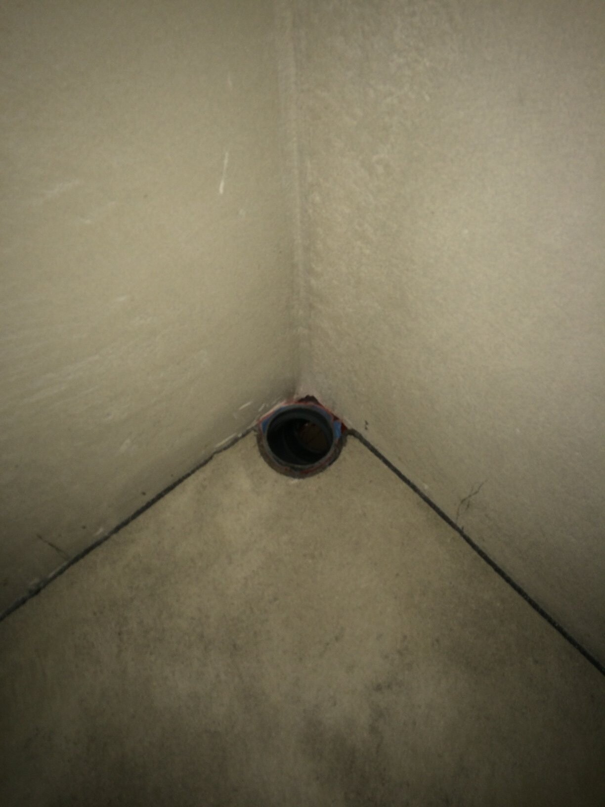

Hauwieneubau26 Apr 2021 09:28ypg schrieb:
Without a downpipe, it is difficult to say anything. The usage pattern of the house/occupants would also need to be known in order to give advice.
It looks to me as if a sauna was planned there but never built. That’s exactly right, a sauna was planned but not implemented. Downpipe as shown in the photo.
Regarding the usage pattern: household of two people. A bathtub is not necessary; walk-in showers and a practical washbasin are essential. And, of course, a toilet.
