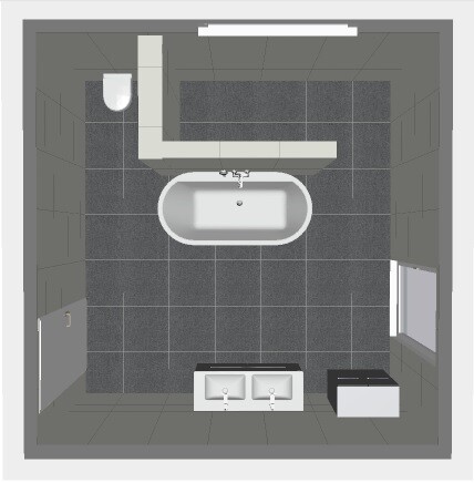

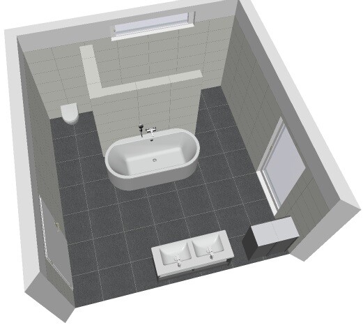

I’ve put together a rough plan without exact dimensions or spacing for the windows and doors. I’ve attached the result as two screenshots and a PDF.
I really like this L-shaped layout now. It allows your bathtub to be placed freely in the room instead of tucked into a corner 🙂
Maybe you’ll like it too.
Oops, I just noticed I probably mixed up the lengths of the two walls, but in principle, it should work without making the space too tight.

olivenbaum29 Mar 2015 11:43Thank you very much for your effort, Jochen.
However, we will stick with our first draft, only changing it so that the washbasin is attached to the shower wall.
I think this makes the bathroom feel more spacious.
We solved the window issue by installing a continuous light strip all around.
I am now satisfied and really like it.
Thank you all for your help.
