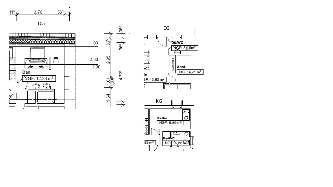

Since there is currently a lot of active planning for some bathrooms here and quite a few good ideas and suggestions have come up, I would also like to put our bathroom up for discussion.
In particular, we want to include a laundry chute, but we are unsure where to place it so that it aligns properly with the chute on the ground floor. We are also undecided about the positioning of the toilet and the sinks.
The bathtub should be placed under the skylight, although the skylight can still be moved.
Perhaps someone here will have a bright idea.

I’ll give it a try here as well.
First, the position of the laundry chute should be determined, as the rest of the planning depends on this. Ideally, it would be positioned so that it runs in the ground floor storage room at the top right and then comes out in the basement laundry room at the bottom right.
Whether this is possible cannot be determined without the measurements of the other rooms.

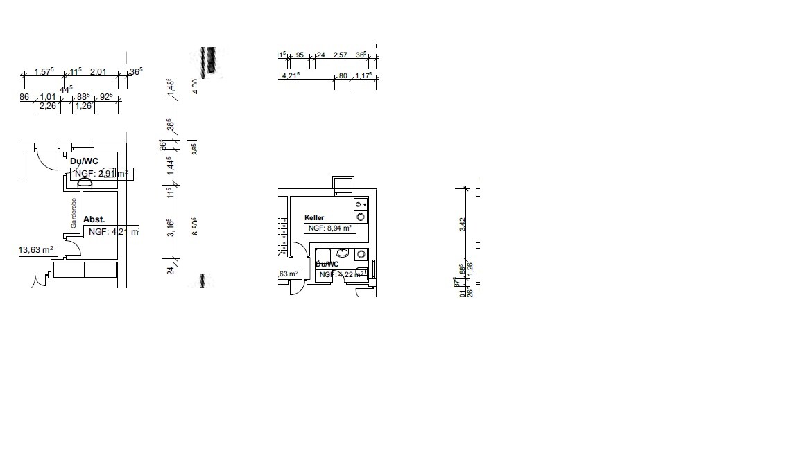

Here are the dimensions from the ground floor and basement.
Our idea was also to place the shaft next to the window on the exterior wall in the bathroom. However, we are concerned that it might look a bit odd in that spot. Additionally, the toilet would be somewhat cramped if it stays where it is currently drawn.
