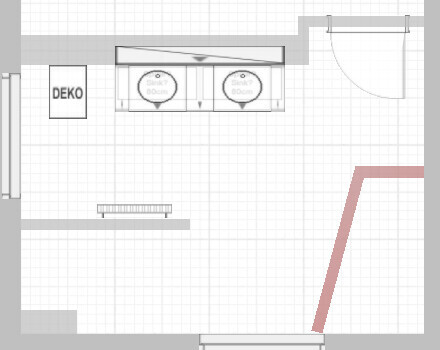

I also think a trapezoidal bathtub would be a good choice, with a layout something like this:
- 2 windows, each 134cm (53 inches) wide
- The shower can be simply separated by a 180cm (71 inches) wall, allowing room for a tall towel radiator to be installed
- Vanity with a width of 180cm (71 inches), so quite spacious
- Toilet niche also 100cm (39 inches) wide
- Both windows remain easily accessible
Just a quick draft using the Alno kitchen planner 😉.

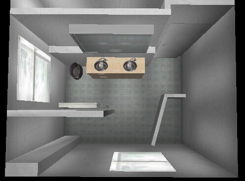

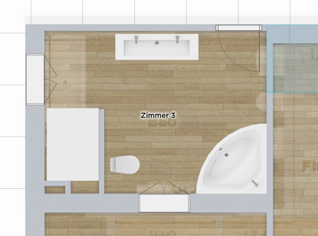

I played around a bit with the shower... after I realized that the width is not 413 but only 313. No one is correcting my sketch here either 🙁
I think the shower fits best there... Personally, I would prefer the toilet there instead...
Bathroom in room 3 with washbasin, toilet on the left, and corner bathtub on the right on a wooden floor
