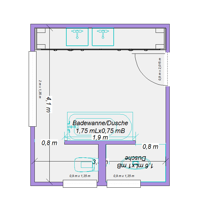

Hello dear community,
we are building an urban villa and would like to install a T-joint in our bathroom. I have also attached a photo of our desired bathroom. Unfortunately, the 90cm (35 inches) rough opening seems very small to me in the planning. Maybe someone has an alternative or also has roughly 90cm (35 inches). I am aware that our planning does not reflect the desired dimensions :P

If flexibility is possible, I would place the bathtub along the transverse wall. The door also seems like it could be moved slightly further downwards on the plan, and then a nice long vanity unit could be installed on the upper wall. On the left, there would be a great window.
kaho67412 Apr 2020 09:39
@kbt09 Exactly. It doesn’t really matter when it comes to the windows. We’ll just quickly adjust the plan :
