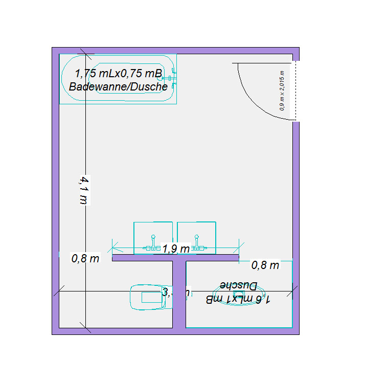

I don’t have the original dimensions from the example. But visually, our example is definitely much larger than what is feasible. The dimensions of the current design are:
Floor plan of a bathroom with an oval bathtub, sink, drain pipes, doors.
12 Apr 2020 00:41
Everything fits fine.
Replace the T with an L.
Place the toilet rotated in the bottom left corner of the plan. With 90cm (35 inches) width for the toilet, a total of 3.70m (12 feet) remains for the rest of the shower.
70cm (28 inches) for the passage into the shower is sufficient. The remaining space is enough for a great walk-in shower that closely matches your desired design.
Enjoy it

Well, off the cuff, I would say your T is installed the wrong way around in the bathroom. Look at how much space you gain if you rotate it:
Floor plan of a bathroom with bathtub, shower, two sinks, toilet, and door.
The big question is, how flexible are the windows?
