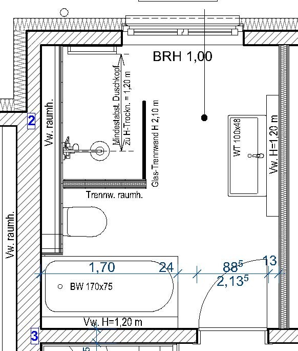

as always, we need to finalize the bathroom planning at very short notice for our building project. Our floor plan is very similar to this one, with the restriction that a toilet needs to be placed at or near the position of the bathtub.
The builder has proposed the following layout (it looks a bit cluttered because the original design is underneath). I still don't like it because I don’t see any practical space for one or two bathroom cabinets. Also, I think the entrance area to the shower might get wet, and I find the numerous bulkhead walls somewhat unnecessary.
I have planned another design that I hope the MEP (mechanical, electrical, and plumbing) engineers can implement as well. I would really appreciate your feedback on it. Thank you very much!
The idea behind the design is to realize a walk-in shower and protect it somewhat from water splashing out with a small glass panel around the corner. I would make the wall between the shower and toilet half-height and add another glass panel above it, possibly a bit longer. Do you think this could work?

Hello, we have settled on the solution. A bit more glass will be installed (side shower wall and half-height towards the bathtub).
Now we are at the point of planning the lighting and need to determine the light outlets. The room height from the top edge of the finished floor is 2.47m (8 ft 1 in), and it has a concrete ceiling. Here are the options I currently see for us; maybe you have another good idea:
1) Lower the ceiling as little as possible and use spotlights (this reduces the room height, adds costs for the suspension, but allows quite a bit of freedom in lighting design)
2) Several recessed or surface-mounted spotlights (the additional light outlets are probably quite expensive, but you save on the suspension)
3) Two LED panels (only one more outlet needed, so relatively cost-effective, although light distribution would probably be worse)
We could also consider using 2-3 wall lights. There is also one outlet available for a mirror light.

Pacmansh schrieb:
with the solution
It’s always helpful in posts with follow-up questions to include the latest version of the planning drawings again 😉

kbt09 schrieb:
It’s always helpful in posts with follow-up questions to include an updated image of the latest planning stage 😉
Sure, sorry about that!
Here’s the floor plan: the wall between the shower and toilet is half-height, with glass above, and the partition wall behind the toilet is also expected to be half-height (1.20m (4 feet)).

And thanks. Lowering the ceiling is not my preferred solution either. However, I find very few bathroom designs without recessed spotlights, which causes my uncertainty.
