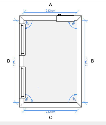

My husband and I are about to buy a bungalow (built in 1967) and renovate it. Naturally, this involves quite a bit of planning and consideration. First, I want to finalize the bathroom layout. This is our first time tackling such a large project, so I would really appreciate plenty of suggestions and tips! Please feel free to share. We have some requirements and ideas, which I outline below:
Important points to consider during planning:
This should be included:
- The original bathroom has a very awkward layout, so our plan is to combine the current guest toilet with the bathroom. Since we intend to integrate the house’s adjoining granny flat into our living area, we will have a separate guest toilet later, and the rough dimensions for our main bathroom will be 3.57 x 2.32 x 2.50 meters (11.7 x 7.6 x 8.2 feet).
- The door width is 76 cm (30 inches), and the distance from the door to the wall is 12 cm (5 inches).
- There are clerestory windows on one wall.
- We want to apply for subsidies for the renovation, so the door must open outwards – would a sliding door be an option? Has anyone had experience with sliding doors in bathrooms?
- I want a partition wall for the toilet so that it is separated from the bathtub!
- A bathtub (preferably 180 x 80 cm (71 x 31 inches) or larger); a corner bathtub is also an option
- Walk-in shower
- Toilet
- Vanity unit (the Geberit One concept seems suitable for us) and a narrow mirrored cabinet: I want to be able to store all everyday bathroom items inside the mirror cabinet or vanity so that the area around the sink stays clear.
- Indirect lighting: ideas for small lamps on the wall, floor, around the bathtub, or the mirrored cabinet are welcome
- An unheated towel rack near the bathtub
- I imagine a tile backsplash (about 120 to 150 cm (47 to 59 inches) high) at the bathtub, shower, and toilet
- For tiles, I currently envision large light-colored square tiles for the floor, concrete-colored tiles for the walls, and one section with color.

We have now been able to measure:
- Room height: 2.54 m (8 feet 4 inches)
- Window sill height: 1.54 m (5 feet 1 inch)
- Current window width: 1.31 m (4 feet 3 inches) and window height: 68 cm (27 inches)
Thanks in advance for any further ideas and advice!

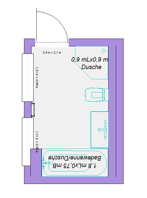

If it were mine, I would arrange the fixtures like this:
I can’t fit a walk-in shower here without compromising the entire room or having to remove other fixtures entirely.
My main goal would be to make sure there’s enough space to move around in the bathroom without constantly having to squeeze past something.
Madame Gazelle22 Feb 2022 06:44I can't fit a walk-in shower in here without compromising the entire room or having to remove other elements.
My main goal is to be able to move around in the bathroom without constantly having to squeeze past things.

Hello K a t j a,
thank you for your consideration! Sometimes you get so focused on your idea that a "change of perspective" can be really helpful – we will take your suggestion of planning without a walk-in shower into account!

Madame Gazelle schrieb:
We’ll keep the idea of planning without a walk-in shower in mind!A walk-in shower usually has a length of about 1.60 meters (5 feet 3 inches). Anything less than 1.40 meters (4 feet 7 inches) hardly works, and even then, you often get some splashing outside. In my opinion, your showers look smaller and all require a door. Perhaps you are confusing walk-in with “curbless” or “barrier-free”?Similar topics
