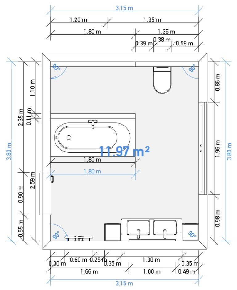

We are currently in the middle of the final design phase and have not yet agreed on the main bathroom on the upper floor.
Attached are part of the floor plan and the current layout as well as an alternative draft.
We want two sinks or a double sink (this will be finalized during material selection), a bathtub, a toilet, a towel radiator, and a walk-in shower. We would prefer the shower to be built with masonry and without a door. However, if space does not allow, we would consider other options.
Our issue with the two drafts is that there is very little space left for additional cabinets or shelves. Unfortunately, we are unsure how to solve this. We are also uncertain whether the sinks positioned on this wall are practical and if noise will be a problem in the bedroom when they are in use. Although the plumbing will be installed within stud walls, we remain skeptical. We are considering swapping the sinks and the bathtub, but this does not seem to provide any additional space either.
Do you have any suggestions for improvements or perhaps completely new ideas?

So far, we’re not 100% satisfied with any option. If we knew that having the sink in the bedroom wouldn’t be an issue, we would stick with the first layout:
But next week we’re visiting a bathroom planner—maybe they’ll have a good idea.
Soundproofing also greatly depends on the wall construction. If you only build lightweight partition walls, you will hear noise regardless of where the taps are installed. It is the architect’s responsibility to design this properly.
I find this option clearly better than most others. Personally, I also like the L-shaped layout from post 5. The shower is nicely enclosed there. But even with the layout shown above, you could swap the bathtub and washbasin if desired. If you are really concerned about noise, that would probably be the better option. Usually, no one takes a bath at night. However, I wouldn’t consider this a decisive factor. If you use the layout above, I would consider placing the towel warmer above the bathtub. This way, it is reasonably accessible from both the bathtub and the shower, and you have space next to the door for cabinets, shelves, or whatever you need...
