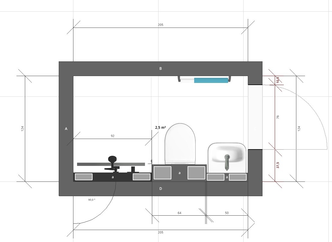

Attached is an updated floor plan.
I have also included the first draft of the interior guest toilet, measuring 205cm by 124cm (81 inches by 49 inches), with a variable door position. I would like to install a “backup shower” here in case there is a queue with kids or guests. What are your thoughts on this?
Bau-beendet3 Apr 2024 20:09@Alrico1
It might be that the towel radiator next to the bathtub is not allowed there. There are specific zones where certain fittings are permitted and others are not. I had a similar situation myself, where it would have been very close to the tub, but it wasn’t allowed. It’s probably better to place it behind the door.

ArminJG223 Apr 2024 22:48Bau-beendet schrieb:
@Alrico1
It might be that the towel radiator next to the bathtub is not allowed there. There are specific zones where certain things are permitted and where they are not. I had a similar situation myself; it would have been very close to the tub, but was not allowed. Most likely it needs to be placed behind the door instead. It depends – if it is just a radiator connected to the underfloor heating system, it doesn’t matter. For a hybrid or fully electric connection, no electrical outlet may be installed within the splash zone – however, the electrical connection itself can be sealed directly. We have planned a radiator with a fully electric heating element in the exit area of the walk-in shower, and this has been approved and accepted by the electrician.
