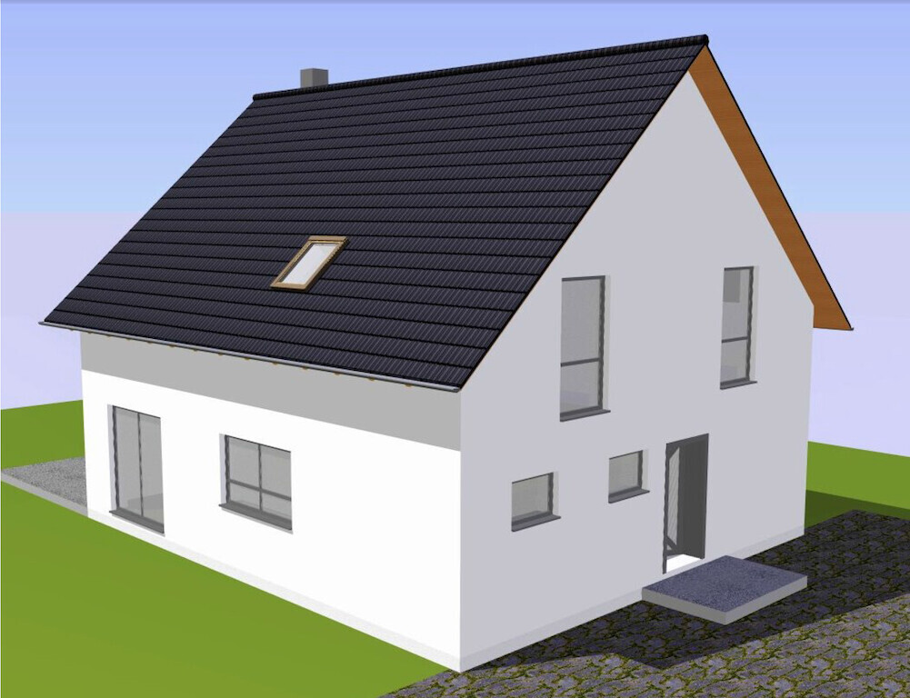

baumann201322 Sep 2014 21:08As shown in the "Bathroom Floor Plan" image, the door can still be moved about 20cm (8 inches) to the left and nearly 60cm (24 inches) to the right. Unfortunately, there is even less flexibility with the window. We want it to be floor-to-ceiling to maximize natural light (the bathroom faces east – receiving the morning sun), and the exterior appearance allows hardly any changes or we like it as planned (see exterior view).
We are also not very happy with the designs. We have already pre-selected the asymmetrical bathtub (without signing anything yet) and were prepared to accept the high cost. As mentioned before, we would prefer a symmetrical hexagonal bathtub, but it seems this is not available with ergonomic design. A straight bathtub (e.g., 180 x 80cm (71 x 31 inches)) would also fully meet our needs, even preferred over a corner tub. Unfortunately, the only options we came up with were variants 3 and 4. Are there any other ideas on how to move the washbasin away from directly in front of the door?
