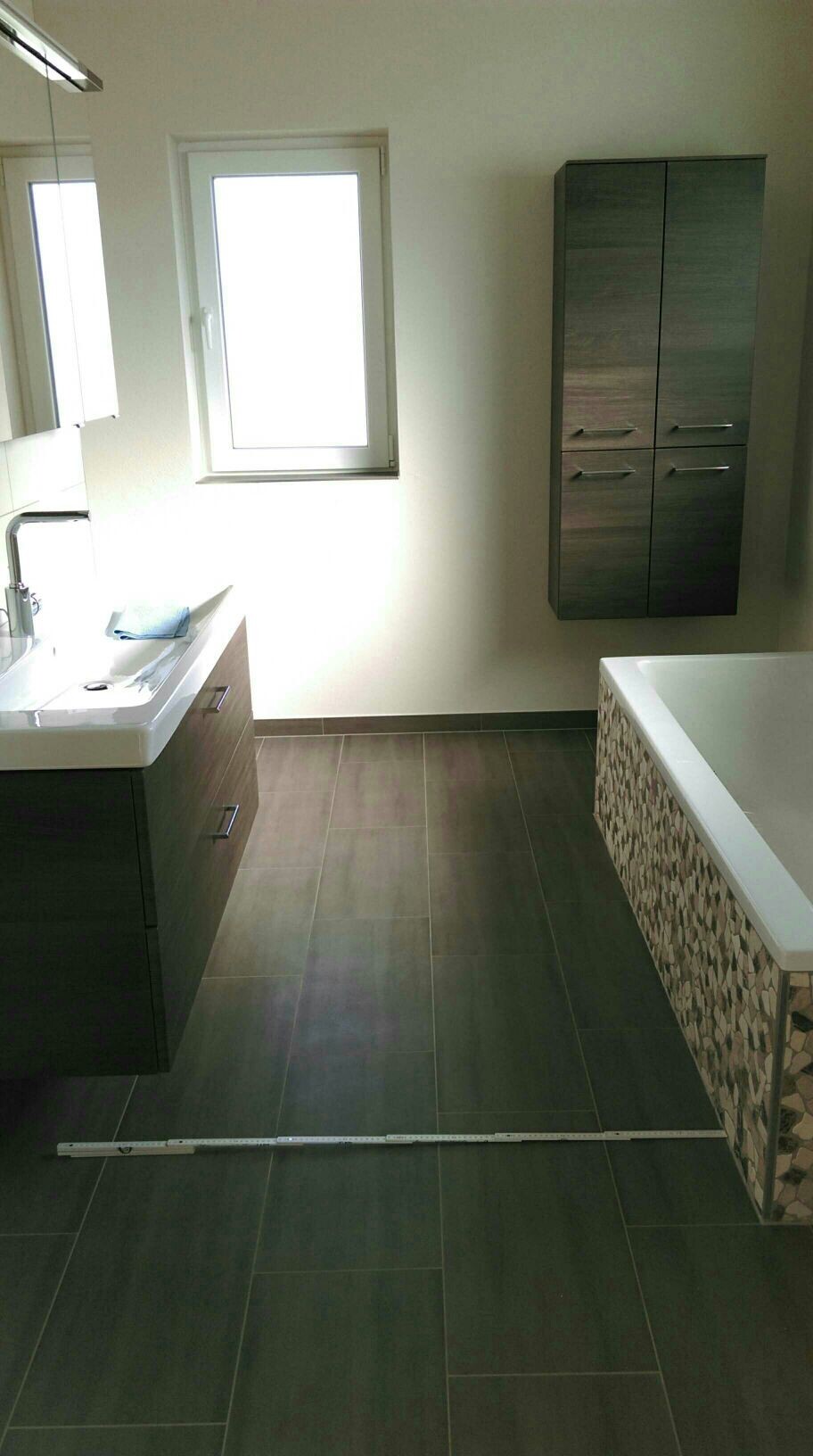

@jx7 ... I don’t understand your argument. In your original plan, you had the washbasin and bathtub placed just like Jochen:
The only difference is that Jochen moved the toilet to the lower right corner to create a properly long wall for the washbasin and allow the shower to be entered generously without water splashing out. There would still be space for a towel warmer or something similar.
The space between the washbasin and the bathtub is about 98 cm (39 inches). I just measured this at my place: 98 cm (39 inches) O_o
I don’t find that narrow at all. There’s enough room for two or three people to use the bathroom comfortably. Alternatively, you could make the shower a bit narrower. At 90 x 200 cm (35 x 79 inches), it would still be a huge shower for the whole family (:
